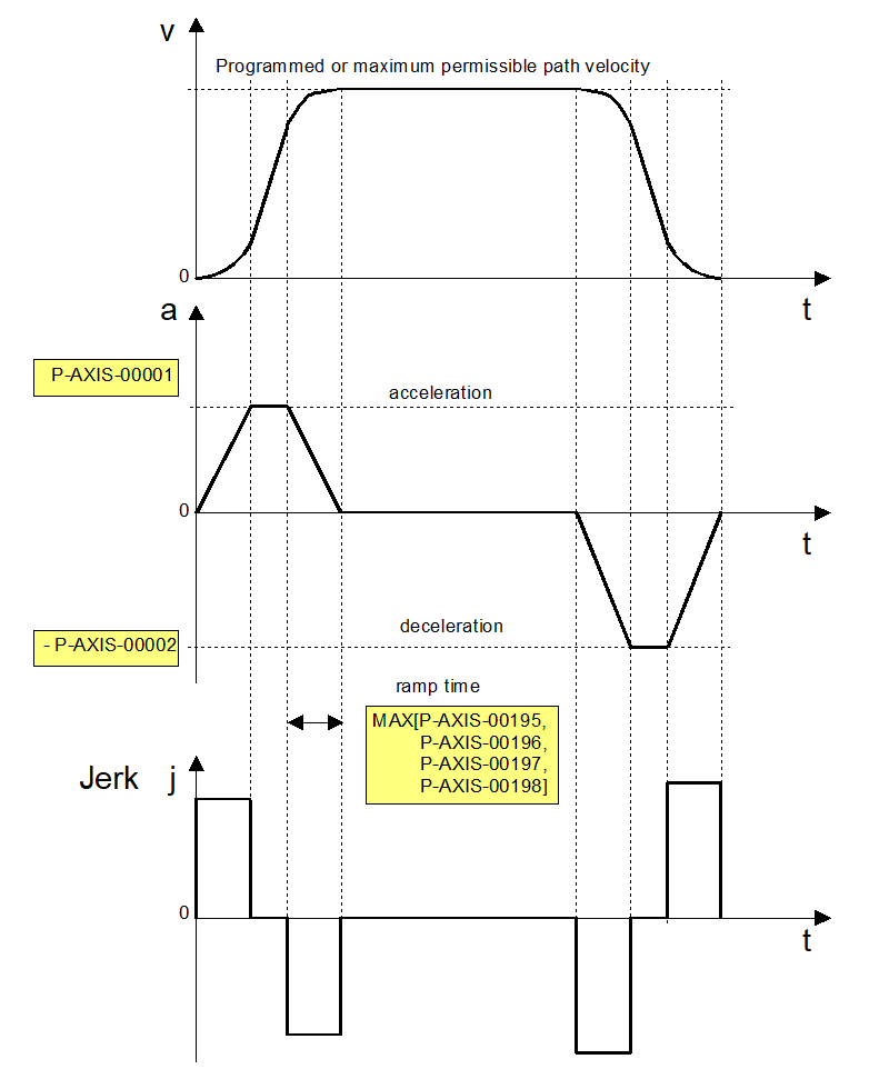

This profile can be activated for path motions and offers advantages for short blocks when acceleration must be built up and decreased over a relatively large number of blocks.
Parameterisation of acceleration ramps with feed blocks is identical to default jerk-limited profiles. However, the parameterisation of different acceleration and deceleration values is less practical for HSC machining.
Setting profile parameters for a rapid traverse block and feedhold also correspond to a default jerk-limited profile.
There are differences in the effectiveness of ramp time parameters for feed blocks.
The maximum of the following parameters is used as ramp time:
Build-up and decrease times for acceleration and deceleration are then identical.
Jerk-limited HSC acceleration profile 1:
Parameters with HSC jerk limitation and feed block
Determining ramp time
When the maximum permissible acceleration and the maximum permissible jerk are specified, the ramp time can be determined using the following equation:
Jerk-limited HSC acceleration profile 2:
where tr: ramp time, j: permissible jerk, a: permissible acceleration
