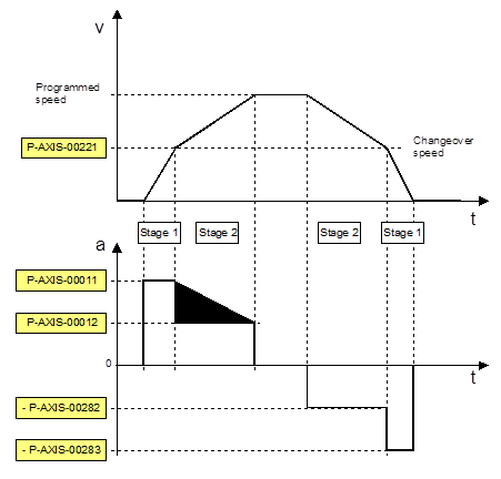

Step-shaped acceleration profile 1:
Parameters of the linear velocity profile
Parameterisation
During both start-up and deceleration, the acceleration profiles each consist of 2 steps which can be parameterised with 2 different acceleration values.
The parameter P-AXIS-00221 sets the changeover velocity from one acceleration value to the other. The linear velocity profile and the stepped acceleration profile of a typical parameterisation variant are depicted in the above figure “Parameters of the linear velocity profile”. Of course, another possible setting is where acceleration value 1 is less than acceleration value 2.
