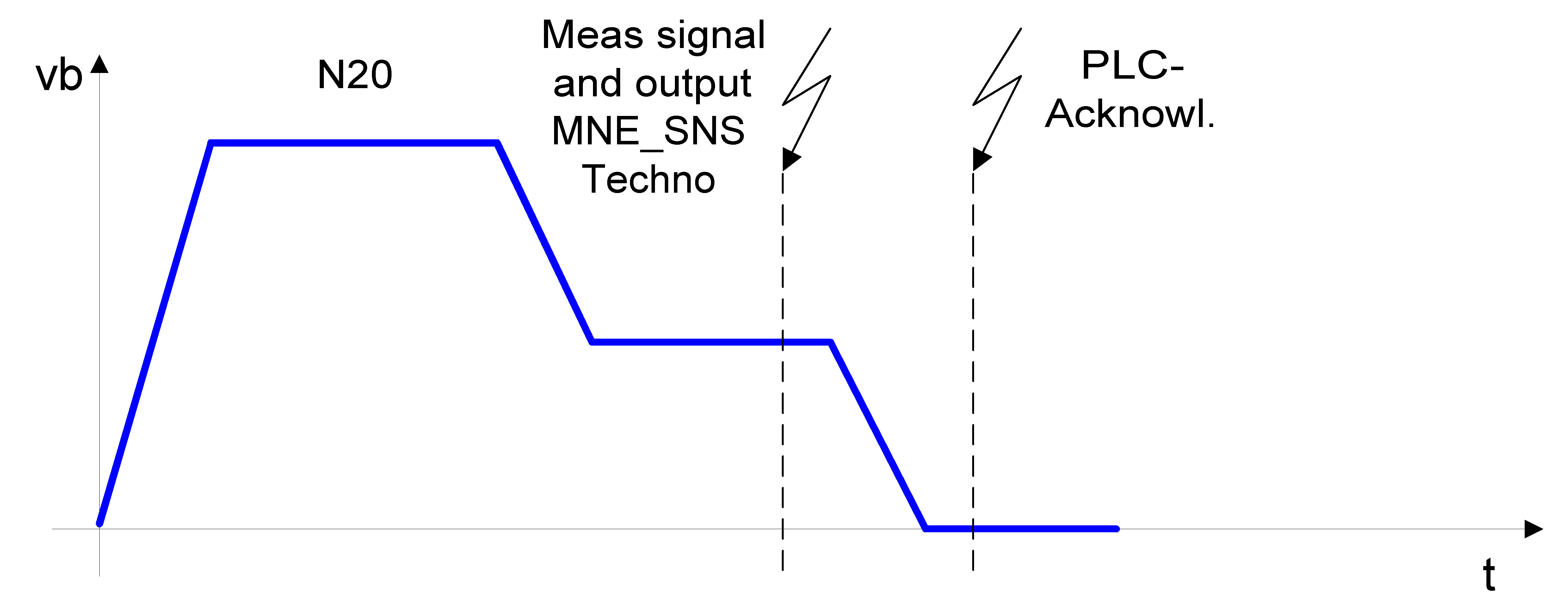

Outputting an MNE_SNS technology function at measuring event (P-CHAN-00435) 1:
Output M function after measuring signal and remove residual path (P-CHAN-00435 = 0)

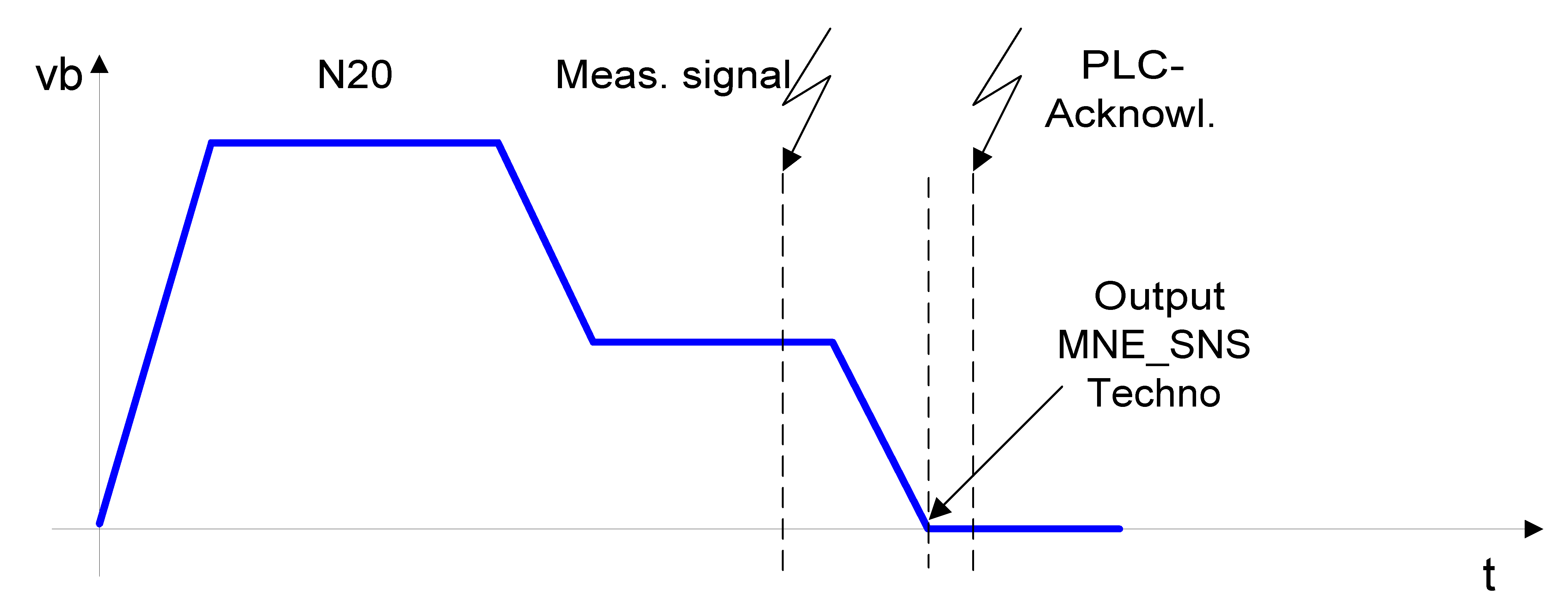

Outputting an MNE_SNS technology function at measuring event (P-CHAN-00435) 2:
Output M function directly after measuring signal (P-CHAN-00435 = 1)
