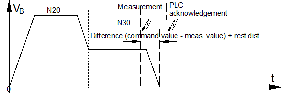

kasto_reject_rest_block = 0:
Reject rest block (P-CHAN-00149) 1:
After output of the M function, motion is continued up to the measurement block (default)

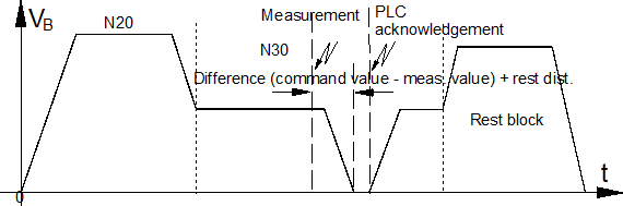

kasto_reject_rest_block = 1:
Reject rest block (P-CHAN-00149) 2:
After output of the M function, reject the residual measurement block
