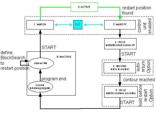

Block search active
The interpolator works in block search mode. No axis motion occurs. As long the block search process in the interpolator remains in the HLI_BS_ACTIVE or HLI_BS_WAIT_FOR_PLC_OFF state, this value indicates TRUE.
Signal flow
CNC → PLC
ST path
gpCh[channel_idx]^.bahn_state.block_search_active_r
Data type
Value range
[TRUE = active - Interpolator works in block search mode., FALSE]
Access
PLC is reading
Block search, state
Indicates the current state of the block search mode in the interpolator.
Signal flow
CNC → PLC
ST path
gpCh[channel_idx]^.bahn_state.block_search_state_r
Data type
INT
Value range
Constant
Value
HLI_BS_INACTIVE
0
HLI_BS_WAIT_FOR_PLC_ON
1
HLI_BS_ACTIVE
2
3
HLI_BS_WAIT_RETURN_TO_CONTOUR
4
HLI_BS_RETURNING_TO_CONTOUR
5
HLI_BS_WAIT_FOR_CONTINUE_CONTOUR
6
Access
PLC is reading

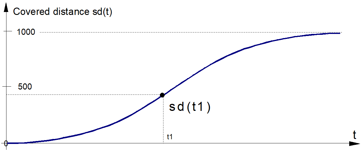

Covered block motion path
Part of the path motion traversed in the current block in relation to the total path.
This status datum contains the current block position referred to the path distance in space in the motion block in per mil sd(t).
Status data: Access via HLI 2:
Signal flow
CNC → PLC
ST path
gpCh[channel_idx]^.bahn_state.covered_distance_r
Data type
DINT
Unit
0.1 %
Access
PLC is reading
Special features
If a main axis participates in the motion, the covered path motion is in relation to the block path of the first three axes. If no main axis participates in the motion, the covered path motion is the position lag with the longest motion time in relation to the block path.

Block search, distance from continuation position
If a NC program is started in block search modus, the NC program is processed in simulative mode (without axis motion) until the continuation position is reached. Block search is then in the HLI_BS_WAIT_FOR_PLC_OFF state and calculates the distance between the actual positions of the axis and the continuation position. If block search is in the HLI_BS_RETURNING_TO_CONTOUR state, this value is refreshed cyclically.
Signal flow
CNC → PLC
ST path
gpCh[channel_idx]^.bahn_state.block_search_path_deviation_r
Data type
UDINT
Unit
0.1 µm
Value range
[0, MAX_SGN32]
Access
PLC is reading
