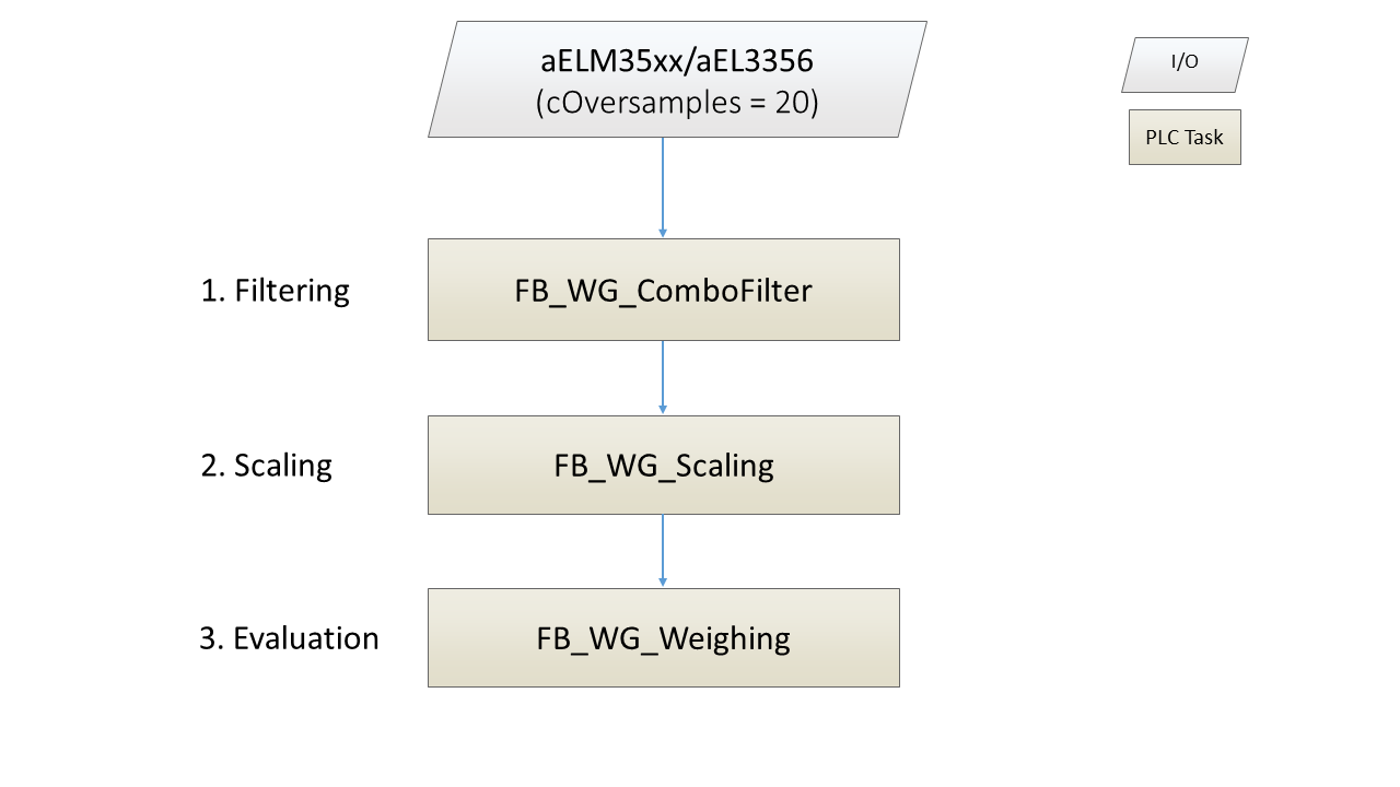

Measuring procedure
A typical measuring procedure for determining the mass of a body consists of three main steps: filtering, scaling and evaluation.
1. Filtering
The signal from the EtherCAT Terminals of the ELM35xx and EL3356 series typically has a level of noise that requires filtering to ensure valid measurement results. The function block FB_WG_ComboFilter offers an effective solution for this by switching a combination of PTn, Moving Average and Notch filters in series. If these filter options are not sufficient, a selection of further filters from the TwinCAT 3 filter library is available.
2. Scaling
The filtered input signal must then be scaled in order to specify the weight in the desired unit (e.g. grams [g]). Scaling is performed by the function block FB_WG_Scaling. Accurate measurement also requires calibration of the PLC function block, which can be carried out using a two-point calibration, for example.
3. Evaluation
