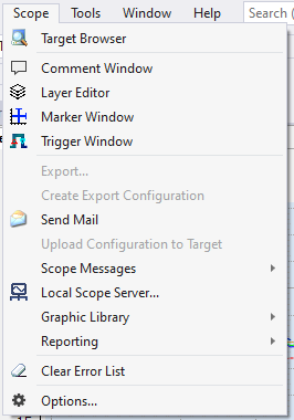

You can go directly to the TwinCAT measurement options in the Visual Studio Options window via the Scope menu item "Options...".
![Bode Plot - Options 1:](Images/png/956094091__Web.png)

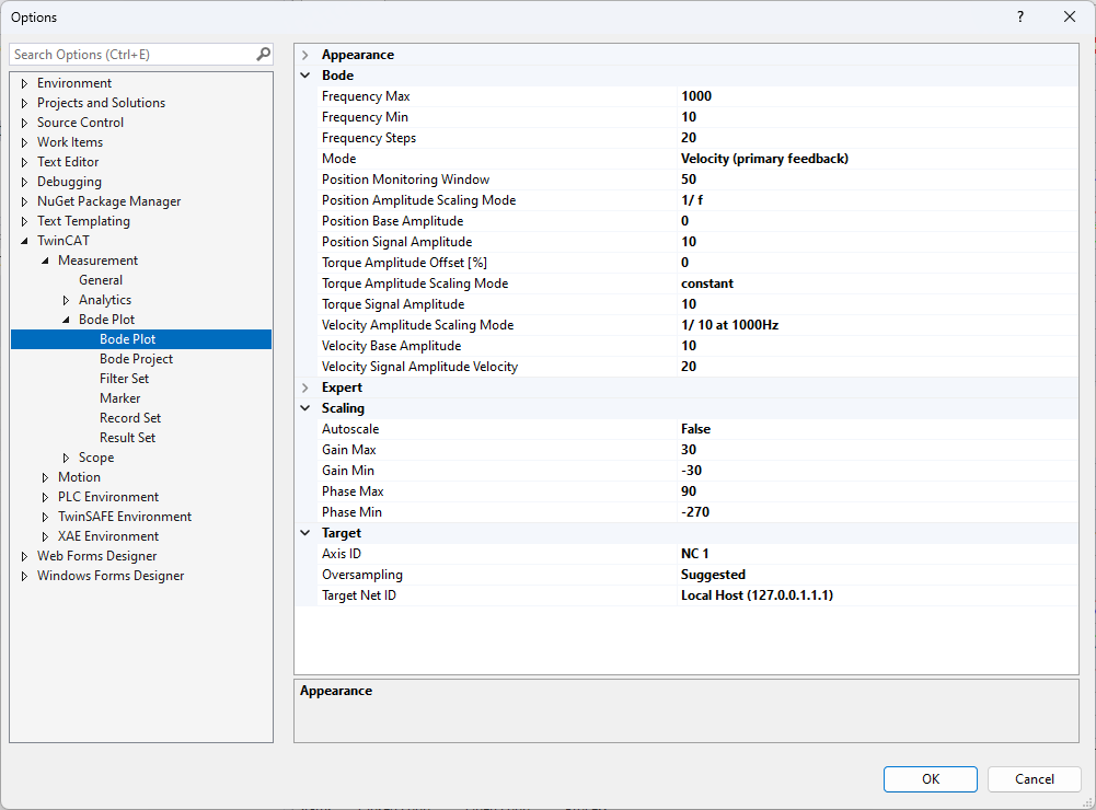

The standard or default settings that serve as the template for newly created elements can be made here.
![Bode Plot - Options 2:](Images/png/957362315__Web.png)
Bode Default Settings
- Bode project: Basic settings for the project can be made here. To detailed description.
- Bode Plot: Definition of the standard Bode Plot settings that are used when a new Bode Plot is appended to a project. To detailed description.
- Filter Set: Definition of the standard filter set settings that are used when a new filter set is appended to a plot. To detailed description.
- Record Set: Definition of the standard record set settings that are used when a new recording is started. To detailed description.
- Result Set: Definition of the standard result set settings that are used when a new result set is appended to a plot. To detailed description.
