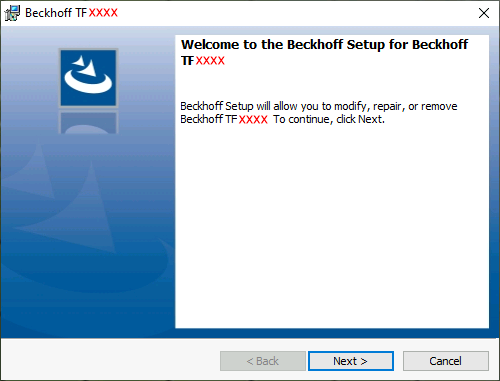

tcpkg install tcpkg install TE1320.BodePlotBase.XAETwinCAT 3 setup: Installation (TwinCAT 3.1 Build 4024 and earlier)
If you are using TwinCAT 3.1 Build 4024 on the Microsoft Windows operating system, install this function via a setup package, which you can download from the Beckhoff website at https://www.beckhoff.com/download.
Depending on the system on which you need the function, the installation can be done on either the engineering or runtime side. The following screenshot is an example of the Setup interface.
To complete the installation process, follow the instructions in the Setup dialog.
