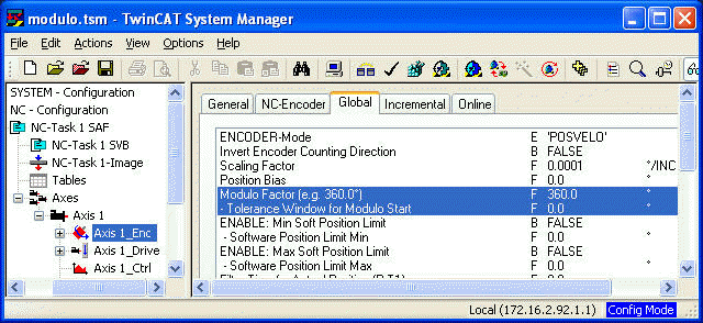

Settings in the TwinCAT System Manager
Modulo positioning refers to a modulo period that can be set in the TwinCAT System Manager. The examples on this page assume a rotary axis with a modulo period of 360 degrees.
Notes on modulo positioning 1:

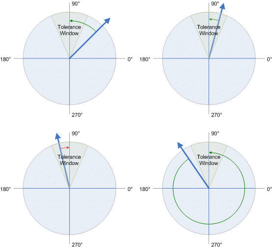

The modulo tolerance window defines a position window around the current modulo set position of the axis. The window width is twice the specified value (set position ± tolerance value). A detailed description of the tolerance window is provided below.
Special features of axis resets
Axis positioning always refers to the set position. The set position of an axis is normally the target position of the last travel command. An axis reset (MC_Reset, controller activation with MC_Power) can lead to a set position that is different from that expected by the user, because in this case the current actual position is used as the set position. The axis reset will reset any following error that may have occurred. If this possibility is not considered, subsequent positioning may lead to unexpected behaviour.
Example: An axis is positioned to 90°, with the result that subsequently the set position of the axis is exactly 90°. A further modulo travel command to 450° in positive direction results in a full turn, with the subsequent modulo position of the axis of once again being exactly 90°. If an axis reset is carried out at this stage, the set position may happen to be somewhat smaller or greater. The new value depends on the actual value of the axis at the time of the reset. However, the next travel command will lead to different results. If the set position is slightly less than 90°, a new travel command to 90° in positive direction only leads to minimum motion. The deviation created by the reset is compensated, and the subsequent set position is once again exactly 90°. However, if the set position after the axis reset is slightly more than 90°, the same travel command leads to a full turn to reach the exact set position of 90°. This problem occurs if complete turns by 360° or multiples of 360° were initiated. For positioning to an angle that is significantly different from the current modulo position, the travel command is unambiguous.
To solve the problem, a modulo tolerance window can be parameterized in the TwinCAT system manager. This ensures that small deviations from the position that are within the window do not lead to different axis behavior. If, for example, a window of 1° is parameterized, in the case described above the axis will behave identically, as long the set position is between 89° and 91°. If the set position exceeds 90° by less than 1°, the axis is re-positioned in positive direction at a modulo start. In both cases, a target position of 90° therefore leads to minimum movement to exactly 90°. A target position of 450° leads to a full turn in both cases.
Notes on modulo positioning 2:Fig.1: Figure: Effect of the modulo tolerance window - modulo target position 90° in positive direction
For values that are within the window range, the modulo tolerance window can therefore lead to movements against the specified direction. For small windows this is usually not a problem, because system deviations between set and actual position are compensated in both directions. This means that the tolerance window may also be used for axes that may only be moved in one direction due to their construction.

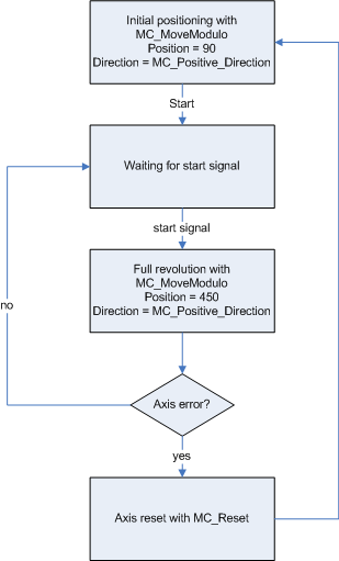

Application example
Within a system, a rotational axis carries out an operation. The starting position for each operation is 90°, and with each cycle the axis is to be positioned by 360° in positive direction. Reverse positioning is not permitted for mechanical reasons. Small reverse positioning is acceptable as part of position control movements.
The modulo tolerance window is set to 1.5° in the System Manager. This ensures that undesirable axis turns after an axis reset are avoided. Since the axis may only be positioned in positive direction, the command MC_MoveModulo with modulo start type positive direction (MC_Positive_Direction) is used. The modulo target position is specified as 450°, since the original orientation is to be reached again after a full turn by 360°. A modulo target position of 90° would not lead to any motion.
The process starts with a basic positioning movement (MC_MoveModulo) to ensure that the starting position is accurate. The step sequence then changes into an execution cycle. In the event of a fault, the axis is reset with MC_Reset and subsequently (at the start of the step sequence) moved to its valid starting position. In this case, 90° is specified as the target position to enable this position to be reached as quickly as possible. No motion occurs if the axis is already at the starting position.
Notes on modulo positioning 3:
Alternatively, the reset step may be carried out at the start of the step sequence, so that the axis is initialised at the start of the process.
