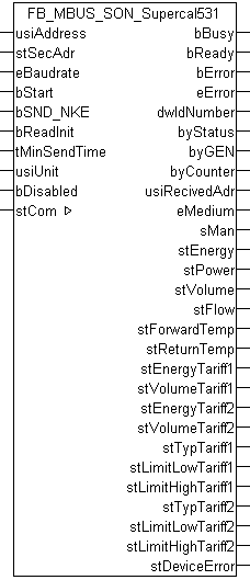

This block is used for reading heat/cold meters from Sontex:
-Supercal 531
The block can only be used in conjunction with the block FB_MBUSKL6781().
Functionality of the function block
usiAddress      : USINT;
stSecAdr        : ST_MBUS_SecAdr;
eBaudrate       : E_MBUS_Baudrate := eMBUS_Baud2400;
bStart          : BOOL;
bSND_NKE        : BOOL := TRUE;
bReadInit       : BOOL := TRUE;
tMinSendTime    : TIME := t#2s;
usiUnit         : USINT;
bDisabled       : BOOL := FALSE;
usiAddress: Primary address of the counter, that shall be readout with this module.
stSecAdr: Secondary address of the counter, that shall be readout with this module.
eBaudrate: 300, 2400, 9600 baud.
bStart: Positive edge on this input, the meter is read out once.
bSND_NKE: TRUE to initialize the meter at each reading, and sets the meter on the first telegram (SND_NKE).
bReadInit: After restarting the PLC, the meter is read out once.
tMinSendTime: Standard t#2s. When this time exceeds, the counter is rereadout. At t#0s the counter is not readout and can be readout with bStart manually.
usiUnit: Unit of the energy values. 0=W/J(h) / 1=KW/KJ(h) / 2=MW/MJ(h) / 3=GW/GJ(h).
bDisabled: TRUE = disable the function block.
bBusy               : BOOL;
bReady              : BOOL;
bError              : BOOL;
eError              : E_MBUS_ERROR;
dwIdNumber          : DWORD;
byStatus            : BYTE;
byGEN               : BYTE;
byCounter           : BYTE;
usiRecivedAdr       : USINT;
eMedium             : E_MBUS_Medium;
sMan                : STRING(3);
stEnergy            : ST_MBus_Info;
stPower             : ST_MBus_Info;
stVolume            : ST_MBus_Info;
stFlow              : ST_MBus_Info;
stForwardTemp       : ST_MBus_Info;
stReturnTemp        : ST_MBus_Info;
stEnergyTariff1     : ST_MBus_Info;
stVolumeTariff1     : ST_MBus_Info;
stEnergyTariff2     : ST_MBus_Info;
stVolumeTariff2     : ST_MBus_Info;
stTypTariff1        : ST_MBus_Info;
stLimitLowTariff1   : ST_MBus_Info;
stLimitHighTariff1  : ST_MBus_Info;
stTypTariff2        : ST_MBus_Info;
stLimitLowTariff2   : ST_MBus_Info;
stLimitHighTariff2  : ST_MBus_Info;
stDeviceError       : ST_MBus_Info;
bBusy: The bBusy output is TRUE while the meter is being read.
bReady: The bReady output is TRUE for one cycle, once meter reading is completed.
bError: The bError output becomes TRUE as soon as an error occurs. The error is described via the variable eError.
eError: The eError output issues an error code when an error occurs (see E_MBUS_ERROR).
dwIdNumber: Serial number of the meter (secondary address).
byStatus: Status of the meter. Please refer to device description for meanings.
byGEN: Meter software version.
byCounter: Transmission counter (number of transmitted RSP_UD).
usiRecivedAdr: Received primary address (0-250).
eMedium: Medium (see E_MBUS_Medium).
sMan: Manufacturer code.
stEnergy: Meter reading, energy consumption (see ST_MBus_Info).
stPower: Current energy consumption (see ST_MBus_Info).
stVolume: Meter reading, volume (see ST_MBus_Info).
stFlow: Current flow (see ST_MBus_Info).
stForwardTemp: Flow temperature (see ST_MBus_Info).
stReturnTemp: Return temperature (see ST_MBus_Info).
stEnergyTariff1: Meter reading, energy consumption tariff 1 (see ST_MBus_Info).
stVolumeTariff1: Meter reading, water consumption tariff 1 (see ST_MBus_Info).
stEnergyTariff2: Meter reading, energy consumption tariff 2 (see ST_MBus_Info).
stVolumeTariff2: Meter reading, water consumption tariff 2 (see ST_MBus_Info).
stTypTariff1: Type tariff 1 (see ST_MBus_Info).
stLimitLowTariff1: Lower limit value tariff 1 (see ST_MBus_Info).
stLimitHighTariff1: Upper limit value tariff 1 (see ST_MBus_Info).
stTypTariff2: Type tariff 2 (see ST_MBus_Info).
stLimitLowTariff2: Lower limit value tariff 2 (see ST_MBus_Info).
stLimitHighTariff2: Upper limit value tariff 2 (see ST_MBus_Info).
stDeviceError: Error message from the device (see ST_MBus_Info).
stCom           : ST_MBUS_Communication;
stCom: About this structure, the block FB_MBUSKL6781() is connected to the meter function blocks (see ST_MBUS_Communication).
