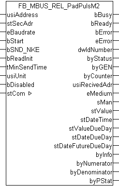

This function block is used for reading energy meters with pulse output from Relay:
-PadPuls M2
-PadPuls M2C
The function block can only be executed together with the function block FB_MBUSKL6781().
Up to 2 pulse generators can be connected to a PadPuls M2 / PadPuls M2C at the same time. The PadPuls M2 / PadPuls M2C behaves like 2 independent slaves.
Functionality of the function block
usiAddress      : USINT;
stSecAdr        : ST_MBUS_SecAdr;
eBaudrate       : E_MBUS_Baudrate := eMBUS_Baud2400;
bStart          : BOOL;
bSND_NKE        : BOOL := TRUE;
bReadInit       : BOOL := TRUE;
tMinSendTime    : TIME := t#2s;
usiUnit         : USINT;
bDisabled       : BOOL := FALSE;
usiAddress: Primary address of the counter, that shall be readout with this module.
stSecAdr: Secondary address of the counter, that shall be readout with this module.
eBaudrate: 300, 2400 baud.
bStart: Positive edge on this input, the meter is read out once.
bSND_NKE: TRUE to initialize the meter at each reading, and sets the meter on the first telegram (SND_NKE).
bReadInit: After restarting the PLC, the meter is read out once.
tMinSendTime: Standard t#2s. When this time exceeds, the counter is rereadout. At t#0s the counter is not readout and can be readout with bStart manually.
usiUnit: Unit of the energy values. 0=W/J(h) / 1=KW/KJ(h) / 2=MW/MJ(h) / 3=GW/GJ(h).
bDisabled: TRUE = disable the function block.
bBusy               : BOOL;
bReady              : BOOL;
bError              : BOOL;
eError              : E_MBUS_ERROR;
dwIdNumber          : DWORD;
byStatus            : BYTE;
byGEN               : BYTE;
byCounter           : BYTE;
usiRecivedAdr       : USINT;
eMedium             : E_MBUS_Medium;
sMan                : STRING(3);
stValue             : ST_MBus_Info;
stDateTime          : ST_MBus_Info;
stValueDueDay       : ST_MBus_Info;
stDateDueDay        : ST_MBus_Info;
stDateFutureDueDay  : ST_MBus_Info;
byInfo              : BYTE;
byNumerator         : BYTE;
byDenominator       : BYTE;
byPStat             : BYTE;
bBusy: The bBusy output is TRUE while the meter is being read.
bReady: The bReady output is TRUE for one cycle, once meter reading is completed.
bError: The bError output becomes TRUE as soon as an error occurs. The error is described via the variable eError.
eError: The eError output issues an error code when an error occurs (see E_MBUS_ERROR).
dwIdNumber: Serial number of the meter (secondary address).
byStatus: Status of the meter. Please refer to device description for meanings.
byGEN: Meter software version.
byCounter: Transmission counter (number of transmitted RSP_UD).
usiRecivedAdr: Received primary address (0-250).
eMedium: Medium (see E_MBUS_Medium).
sMan: Manufacturer code.
stValue: Meter reading (see ST_MBus_Info).
stDateTime: Current date (see ST_MBus_Info).
stValueDueDay: Due-date counter (see ST_MBus_Info).
stDateDueDay: Last due-date, date of the due-date counter (see ST_MBus_Info).
stDateFutureDueDay: Next (future) due-date (see ST_MBus_Info).
byInfo: 1 byte with information about tariff and sampling method.
byNumerator: Numerator of pulse increment (1..99).
byDenominator: denominator of pulse increment (1..255, 0 -> 256).
byPStat: State of inputs (current input state of the ports).
stCom          : ST_MBUS_Communication;
stCom: About this structure, the block FB_MBUSKL6781() is connected to the meter function blocks (see ST_MBUS_Communication).
