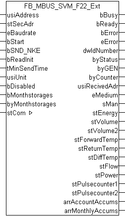

FB_MBUS_SVM_F22_Ext
This function block is used to read heat meters from Metrima:
-F22
The function block can only be executed together with the function block FB_MBUSKL6781().

Functionality of the function block
usiAddress : USINT;
stSecAdr : ST_MBUS_SecAdr;
eBaudrate : E_MBUS_Baudrate := eMBUS_Baud2400;
bStart : BOOL;
bSND_NKE : BOOL := TRUE;
bReadInit : BOOL := TRUE;
tMinSendTime : TIME := t#2s;
usiUnit : USINT;
bDisabled : BOOL := FALSE;
bMonthstorages : BOOL;
byMonthstorages : BYTE;
usiAddress: Primary address of the counter, that shall be readout with this module.
stSecAdr: Secondary address of the counter, that shall be readout with this module.
eBaudrate: 300, 2400, 9600 baud.
bStart: Positive edge on this input, the meter is read out once.
bSND_NKE: TRUE to initialize the meter at each reading, and sets the meter on the first telegram (SND_NKE).
bReadInit: After restarting the PLC, the meter is read out once.
tMinSendTime: Standard t#2s. When this time exceeds, the counter is rereadout. At t#0s the counter is not readout and can be readout with bStart manually.
usiUnit: Unit of the energy values. 0=W/J(h) / 1=KW/KJ(h) / 2=MW/MJ(h) / 3=GW/GJ(h).
bDisabled: TRUE = disable the function block.
bMonthstorages:
byMonthstorages:
bBusy : BOOL;
bReady : BOOL;
bError : BOOL;
eError : E_MBUS_ERROR;
dwIdNumber : DWORD;
byStatus : BYTE;
byGEN : BYTE;
byCounter : BYTE;
usiRecivedAdr : USINT;
eMedium : E_MBUS_Medium;
sMan : STRING(3);
stEnergy : ST_MBus_Info;
stVolume : ST_MBus_Info;
stVolume2 : ST_MBus_Info;
stForwardTemp : ST_MBus_Info;
stReturnTemp : ST_MBus_Info;
stDiffTemp : ST_MBus_Info;
stFlow : ST_MBus_Info;
stPower : ST_MBus_Info;
stPulsecounter1 : ST_MBus_Info;
stPulsecounter2 : ST_MBus_Info;
arrAccountAccums : ARRAY [1..2] OF ST_MBus_F22;
arrMonthlyAccums : ARRAY [1..37] OF ST_MBus_F22;
bBusy: The bBusy output is TRUE while the meter is being read.
bReady: The bReady output is TRUE for one cycle, once meter reading is completed.
bError: The bError output becomes TRUE as soon as an error occurs. The error is described via the variable eError.
eError: The eError output issues an error code when an error occurs (see E_MBUS_ERROR).
dwIdNumber: Serial number of the meter (secondary address).
byStatus: Status of the meter. Please refer to device description for meanings.
byGEN: Meter software version.
byCounter: Transmission counter (number of transmitted RSP_UD).
usiRecivedAdr: Received primary address (0-250).
eMedium: Medium (see E_MBUS_Medium).
sMan: Manufacturer code.
stEnergy: Meter reading, energy consumption (see ST_MBus_Info).
stVolume: Meter reading, volume (see ST_MBus_Info).
stVolume2: Meter reading, volume (Corresponding to energy registers) (see ST_MBus_Info).
stForwardTemp: Flow temperature (see ST_MBus_Info).
stReturnTemp: Return temperature (see ST_MBus_Info).
stDiffTemp: Temperature difference (see ST_MBus_Info).
stFlow: Current flow (see ST_MBus_Info).
stPower: Current energy consumption (see ST_MBus_Info).
stPulsecounter1: Pulse counter 1 (see ST_MBus_Info).
stPulsecounter2: Pulse counter 2 (see ST_MBus_Info).
arrAccountAccums: 2 Account (Energy, Volume from watermeter, Volume according to energy, Pulse counter 1 H.C.A coded, Pulse counter 2 H.C.A coded, Date). Values are read only if bMonthstorages = true.
arrMonthlyAccums: Max. 37 monthstorages (Energy, Volume from watermeter, Volume according to energy, Pulse counter 1 H.C.A coded, Pulse counter 2 H.C.A coded, Date). Values are read only if bMonthstorages = true. The number of values depends on the variable byMonthstorages.
stCom : ST_MBUS_Communication;
stCom: About this structure, the block FB_MBUSKL6781() is connected to the meter function blocks (see ST_MBUS_Communication).
