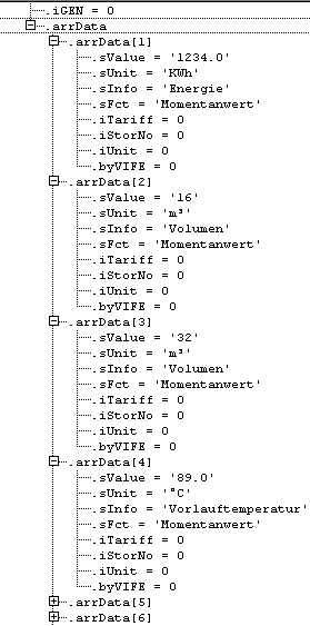

arrData: Maximum cMBUS_MaxData values of the first telegram (see ST_MBus_Data). The meaning of the values are explained in the M-Bus protocol of the device.

Example view:
