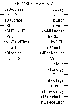

This function block is used to read electricity meters from EMH:
-MIZ
The function block can only be executed together with the function block FB_MBUSKL6781().
Functionality of the function block
usiAddress     : USINT;
stSecAdr       : ST_MBUS_SecAdr;
eBaudrate      : E_MBUS_Baudrate := eMBUS_Baud2400;
bStart         : BOOL;
bSND_NKE       : BOOL := TRUE;
bReadInit      : BOOL := TRUE;
tMinSendTime   : TIME := t#2s;
usiUnit        : USINT;
bDisabled      : BOOL := FALSE;
usiAddress: Primary address of the counter, that shall be readout with this module.
stSecAdr: Secondary address of the counter, that shall be readout with this module.
eBaudrate: 300, 2400, 9600 baud.
bStart: Positive edge on this input, the meter is read out once.
bSND_NKE: TRUE to initialize the meter at each reading, and sets the meter on the first telegram (SND_NKE).
bReadInit: After restarting the PLC, the meter is read out once.
tMinSendTime: Standard t#2s. When this time exceeds, the counter is rereadout. At t#0s the counter is not readout and can be readout with bStart manually.
usiUnit: Unit of the energy values. 0=W/J(h) / 1=KW/KJ(h) / 2=MW/MJ(h) / 3=GW/GJ(h).
bDisabled: TRUE = disable the function block.
bBusy          : BOOL;
bReady         : BOOL;
bError         : BOOL;
eError         : E_MBUS_ERROR;
dwIdNumber     : DWORD;
byStatus       : BYTE;
byGEN          : BYTE;
byCounter      : BYTE;
usiRecivedAdr  : USINT;
eMedium        : E_MBUS_Medium;
sMan           : STRING(3);
stEnergy       : ST_MBus_Info;
stPower        : ST_MBus_Info;
stVoltage      : ST_MBus_Info;
stCurrent      : ST_MBus_Info;
stFrequency    : ST_MBus_Info;
stPowerfactor  : ST_MBus_Info;
stDeviceError  : ST_MBus_Info;
bBusy: The bBusy output is TRUE while the meter is being read.
bReady: The bReady output is TRUE for one cycle, once meter reading is completed.
bError: The bError output becomes TRUE as soon as an error occurs. The error is described via the variable eError.
eError: The eError output issues an error code when an error occurs (see E_MBUS_ERROR).
dwIdNumber: Serial number of the meter (secondary address).
byStatus: Status of the meter. Please refer to device description for meanings.
byGEN: Meter software version.
byCounter: Transmission counter (number of transmitted RSP_UD).
usiRecivedAdr: Received primary address (0-250).
eMedium: Medium (see E_MBUS_Medium).
sMan: Manufacturer code.
stEnergy: Meter reading, energy consumption (see ST_MBus_Info).
stPower: Current energy consumption (see ST_MBus_Info).
stVoltage: Voltage (see ST_MBus_Info).
stCurrent: Current (see ST_MBus_Info).
stFrequency: Frequeny (see ST_MBus_Info).
stPowerfactor: Power factor (see ST_MBus_Info).
stDeviceError: Error message from the device (see ST_MBus_Info).
stCom          : ST_MBUS_Communication;
stCom: About this structure, the block FB_MBUSKL6781() is connected to the meter function blocks (see ST_MBUS_Communication).
