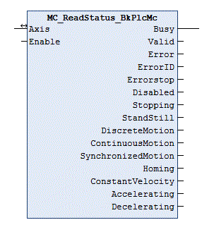

MC_ReadStatus_BkPlcMc (from V3.0)
The function block determines the current state of an axis.

If Enable is TRUE, the function block checks the transferred axis interface and decodes the internal state information. A FALSE state at Enable clears all pending output signals.
![]() | This function block requires no time and no preconditions for executing its tasks. The outputs Error and Busy will never assume the value TRUE and only exist for compatibility reasons. |
![]() | Observe outputs The outputs Error and ErrorID indicate the state of the function block, not that of the axis. |
To read the current error code of the axis a MC_ReadAxisError_BkPlcMc() function block must be used.
