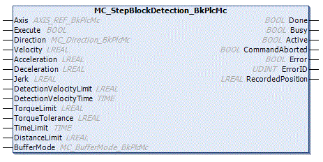

MC_StepBlockDetection_BkPlcMc
The function block is used for referencing via a limit switch. The function block outputs the position of the cam to the outside via RecordedPosition. No position is set.

On a rising edge at Execute the function block checks the transferred axis interface. A number of problems can be detected and reported during this process:
- At Direction, MC_Positive_Direction_BkPlcMc, MC_Negative_Direction_BkPlcMc, is accepted
- The DistanceLimit must have a value greater than the increment resolution.
The parameters Velocity, Acceleration, Deceleration and Jerk are transferred to MC_MoveVelocity_BkPlcMc. After the cam has been detected, the position is communicated via RecordedPosition and a MC_Halt_BkPlcMc stops the movement.
A hard stop is detected when the actual velocity for the time DetectionVelocityTime is below DetectionVelocityLimit or the current pressure is greater than TorqueLimit minus TorqueTolerance. If no fixed stop is detected within DistanceLimit or TimeLimit, referencing is aborted with an error.
During processing, the function block reports Busy and Active. After successful processing Done is reported back. If a subordinate function block reports an error, this is reported via Error and ErrorID.
