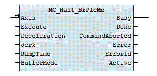

MC_Halt_BkPlcMc (from V3.0)
The function block cancels a current axis motion and monitors the stop operation.

Inputs
Execute: BOOL;
Deceleration: LREAL; (ab/from V3.0.5)
Jerk: LREAL; (ab/from V3.0.5)
RampTime: LREAL; (ab/from V3.0.5)
BufferMode: MC_BufferMode_BkPlcMc:=Aborting_BkPlcMc; (ab/from V3.0.8)
Name | Type | Description |
Execute | BOOL | A rising edge at this input ends a movement being carried out by the axis. |
Deceleration | LREAL | [mm/s2] The deceleration to be applied. |
Jerk | LREAL | [mm/s3] The jerk to be applied. |
RampTime | LREAL | [s] The required stopping time. |
BufferMode | MC_BufferMode_BkPlcMc | reserved. This input is provided in preparation for a future build. It should currently either not be assigned or assigned the constant Aborting_BkPlcMc. (from V3.0.8) |
Inputs/outputs
VAR_INOUT
Axis: Axis_Ref_BkPlcMc;
Axis | Axis_Ref_BkPlcMc | Here, the address of a variable of type Axis_Ref_BkPlcMc should be transferred. |
Outputs
Busy: BOOL;
Done: BOOL;
Error: BOOL;
ErrorID: UDINT;
Active: BOOL;
CommandAborted: BOOL;
Busy | BOOL | Indicates that a command is being processed. |
Done | BOOL | This indicates successful processing of the operation. |
Active | BOOL | Indicates that a command is being processed. |
CommandAborted | BOOL | Indicates that processing of this command was aborted by another command. |
The behavior of the function block is identical to that of the MC_Stop_BkPlcMc() function block. The only difference is that processing of the command can be aborted by other function blocks.
