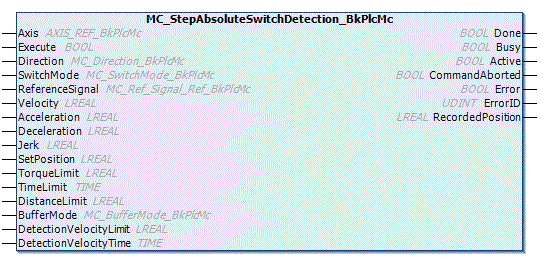

MC_StepAbsoluteSwitchDetection_BkPlcMc
The function block is used for referencing via a limit switch. The function block outputs the position of the cam to the outside via RecordedPosition. No position is set.

On a rising edge at Execute only MC_Positive_Direction_BkPlcMc, MC_Negative_Direction_BkPlcMc, MC_SwitchPositive_Direction_BkPlcMc, MC_SwitchNegative_Direction_BkPlcMc are accepted at the parameter Direction. The parameters Velocity, Acceleration, Deceleration and Jerk are transferred to MC_MoveVelocity_BkPlcMc. After the cam has been detected, the position is communicated via RecordedPosition and a MC_Halt_BkPlcMc aborts the movement.
During processing, the function block reports Busy and Active. After successful processing Done is reported back. If a subordinate function block reports an error, this is reported via Error and ErrorID.
