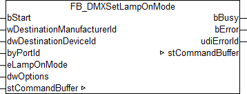

FB_DMXSetLampOnMode
FB_DMXSetLampOnMode 1:
This function block defines the switch-on characteristics of the DMX device. The block FB_DMXGetLampOnMode() can be used to read the set value.
bStart                      : BOOL;
wDestinationManufacturerId  : WORD;
dwDestinationDeviceId       : DWORD;
byPortId                    : BYTE;
eLampOnMode                 : E_DMXLampOnMode := eDMXLampOnModeOff;
dwOptions                   : DWORD := 0;
bStart: The command is started by a positive edge at this input.
wDestinationManufacturerId: Unique manufacturer ID of the DMX device.
dwDestinationDeviceId: Unique device ID of the DMX device.
byPortId: Channel within the addressed DMX device. Sub-devices are addressed through the Port ID. The root device always has the Port ID 0.
eLampOnMode: This parameter defines the switch-on characteristics of the DMX device.
dwOptions: Options (currently not used).
bBusy               : BOOL;
bError              : BOOL;
udiErrorId          : UDINT;
bBusy: When the block is activated the output is set, and it remains active until execution of the command has been completed.
bError: This output is switched to TRUE as soon as an error occurs during the execution of a command. The command-specific error code is contained in udiErrorId. Only valid if bBusy is FALSE.
udiErrorId: Contains the command-specific error code of the most recently executed command. Only valid if bBusy is FALSE. See Error codes.
stCommandBuffer         : ST_DMXCommandBuffer;
stCommandBuffer: A reference to the structure for communication (the buffer) with the FB_EL6851CommunicationEx() block.
