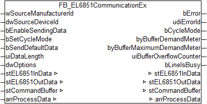

FB_EL6851CommunicationEx
The EL6851 should always be accessed via this block. This applies both to the transmission of the cyclic DMX data and to the transmission of the RDM commands.
If data is to be transmitted cyclically to the DMX devices, then set the bEnableSendingData input to TRUE, the bSetCycleMode input to TRUE, the bSendDefaultData input to FALSE and the uiDataLength input to the corresponding length (in bytes). The data to be transmitted can be specified via the arrProcessData variable.
If RDM commands are to be transmitted, then set the bEnableSendingData input to FALSE and the bSetCycleMode input to FALSE. The blocks for the DMX/RDM commands do not directly access the EL6851 process image, but store the individual DMX/RDM commands in a buffer instead. The FB_EL6851Communication() block reads the commands sequentially from this buffer and forwards them to the EL6851. This prevents multiple blocks accessing the EL6851 process image at the same time. The buffer in which the DMX/RDM commands are stored is contained in a variable of type ST_DMXCommandBuffer. There is one instance of the FB_EL6851Communication() block and one variable of type ST_DMXCommandBuffer per EL6851.
The extent to which the buffer is utilized can be determined from the outputs of the block. If the buffer is regularly overflowing, you should analyse the level of utilisation of the PLC task with the aid of the TwinCAT System Manager.
The FB_EL6851Communication() block can be called in a separate, faster task if necessary. In this case, the faster task in which the FB_EL6851Communication() block is called should have a higher priority than the TASK in which the block for the RDM commands is called.
You will find examples of both modes of operation in the appendix.

wSourceManufacturerId : WORD := 16#42_41;
dwSourceDeviceId : DWORD := 16#12_13_14_15;
bEnableSendingData : BOOL := TRUE;
bSetCycleMode : BOOL := TRUE;
bSendDefaultData : BOOL;
uiDataLength : UINT;
dwOptions : DWORD;
wSourceManufacturerId: Unique manufacturer ID of the DMX device. Should be 0x4241 according to the ESTA.
dwSourceDeviceId: Unique device ID of the DMX device. Can be freely assigned.
bEnableSendingData: If the terminal is in cycle mode (bCycleMode output = TRUE), then transmission can be activated (TRUE) or blocked (FALSE) with this block.
bSetCycleMode: Activates the cycle mode. The cyclic process data can be transmitted to the DMX devices in cycle mode. Cycle mode must be deactivated to transmit the RDM/DMX commands.
bSendDefaultData: The standard values will be transmitted in cycle mode if this input is active (TRUE).
uiDataLength: This input is only relevant if cycle mode is active. It indicates the length of the DMX512 frame in bytes.
dwOptions: Options (currently not used).
bError : BOOL;
udiErrorId : UDINT;
bCycleMode : BOOL;
byBufferDemandMeter : BYTE;
byBufferMaximumDemandMeter : BYTE;
uiBufferOverflowCounter : UINT;
bLineIsBusy : BOOL;
bError: This output is switched to TRUE as soon as an error occurs during the execution of a command. The command-specific error code is contained in udiErrorId. Only valid if bBusy is FALSE.
udiErrorId: Contains the command-specific error code of the most recently executed command. Only valid if bBusy is FALSE. See Error codes.
bCycleMode: Is TRUE if cycle mode is active (see also bSetCycleMode input).
byBufferDemandMeter: Buffer utilisation (0 – 100%).
byBufferMaximumDemandMeter: Previous maximum utilisation of the respective buffer (0 – 100%).
uiBufferOverflowCounter: Number of buffer overflows to date.
bLineIsBusy: This output is set as long as the FB_EL6851Communication() block is processing DMX/RDM commands.
stEL6851InData : ST_EL6851InDataEx;
stEL6851OutData : ST_EL6851OutData;
stCommandBuffer : ST_DMXCommandBuffer;
arrProcessData : ARRAY[1..512] OF BYTE;
stEL6851InData: Structure in the EL6851 input process image. It is used for communication from the EL6851 to the PLC.
stEL6851OutData: Structure in the EL6851 output process image. It is used for communication from the PLC to the EL6851.
stCommandBuffer: A reference to the structure for communication (the buffer) with the FB_EL6851Communication()-block.
arrProcessData: The data that are to be transmitted cyclically to the DMX devices are transferred to the block via this variable. Cycle mode must be active for this to take place (see also bSetCycleMode input).
