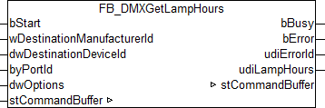

This function block reads the number of hours in which the lamp was on. The block FB_DMXSetLampHours() can be used to edit the hour counter.
bStart : BOOL;
wDestinationManufacturerId : WORD;
dwDestinationDeviceId : DWORD;
byPortId : BYTE;
dwOptions : DWORD := 0;
bStart: The command is started by a positive edge at this input.
wDestinationManufacturerId: Unique manufacturer ID of the DMX device.
dwDestinationDeviceId: Unique device ID of the DMX device.
byPortId: Channel within the addressed DMX device. Sub-devices are addressed through the Port ID. The root device always has the Port ID 0.
dwOptions: Options (currently not used).
bBusy : BOOL;
bError : BOOL;
udiErrorId : UDINT;
udiLampHours : UDINT;
bBusy: When the block is activated the output is set, and it remains active until execution of the command has been completed.
bError: This output is switched to TRUE as soon as an error occurs during the execution of a command. The command-specific error code is contained in udiErrorId. Only valid if bBusy is FALSE.
udiErrorId: Contains the command-specific error code of the most recently executed command. Only valid if bBusy is FALSE. See Error codes.
udiLampHours: Number of hours in which the lamp was switched on.
stCommandBuffer : ST_DMXCommandBuffer;
stCommandBuffer: A reference to the structure for communication (the buffer) with the FB_EL6851CommunicationEx() block.
