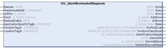

IOL_IdentificationAndDiagnosis
Function block for identification and diagnosis of an IO-Link device. This function block is implemented by the Common IO-Link Profile. The ApplicationSpecificTag, the FunctionTag and the LocationTag of an IO-Link device can be written. The function classes and ProfileIDs of a device can be read. Additionally the function block gives a diagnosis on the state of a device and its identification, which can include the Vendor Name, Vendor ID, Device Name, and Device ID.
Inputs
Name | Type | Description |
Execute | BOOL | A trigger causes the function selected with the Function variable to be executed: |
MasterAoENetid | T_AmsNetid | AMS NETID of the IO-Link master |
IolPort | IO-Link port of the IO-Link device | |
Func | This variable selects the functionality to be triggered by a request: 0 = no_func A request is neglected, no function is executed 1 = rd_all A request starts the read-back of the current identification and diagnostic parameter values from the device. 2 = rd_diag A request starts reading back the current diagnostic parameter values by reading DeviceStatus and DetailedDeviceStatus from the device. 3 = wr_ ident A request causes a previously created value for ApplicationSpecificTagIn, LocationTagIn and FunctionTagIn to be written to the device. | |
BackupEnable | BOOL | This variable configures the behavior of the FB in case of the requested function wr_ident. "true" = enabled The backup mechanism is triggered by the FB. "false" = disabled The backup mechanism is not triggered by the FB. |
ApplicationSpecificIN | String(32) | Parameters of the IO-Link device |
FunctionTagIN | String(32) | Parameters of the IO-Link device |
LoactionTagIN | String(32) | Parameters of the IO-Link device |
Outputs
Done | BOOL | The signal is set when the FB has completed a requested operation. |
Busy | BOOL | The signal is set when the FB executes a requested operation. |
Error | BOOL | The signal is set when an error occurred during the execution of a requested operation. |
AdsError | E_ADSErr | ADS error code |
IoLError | IO-Link error | |
State | The value represents the current status of the FB operation and the executed functions. The content is system specific and contains the status information. | |
ProfileIDList | ARRAY [0..31] of E_IolProfileIdentifier | List of ProfileIDs supported by the device |
FunctionClassIDList | ARRAY [0..31] of E_IolProfileIdentifier | List of FunctionClassIDs supported by the device |
IdentificationObjects | Structured list of identification objects, for more details. | |
DeviceOK | BOOL | The signal is set if no further diagnostic information is available, it is false if further information is available at DeviceStatus and DetailedDeviceStatus. |
DeviceStatus | Status of the IO-Link device | |
DetailedDeviceStatus | ARRAY [0..63] of ST_DetailedDeviceStatusEntry |
