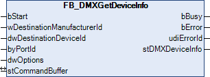

FB_DMXGetDeviceInfo
FB_DMXGetDeviceInfo 1:
This function block queries all relevant information from a DMX device.
Applying a positive edge to the bStart input starts the function block, and the bBusy output goes TRUE. The wDestinationManufacturerId and dwDestinationDeviceId inputs address the DMX device. The byPortId input defines the channel within the addressed DMX device. If the execution of the command has been completed, the bBusy output goes back to FALSE. The outputs bError, udiErrorId and stDMXDeviceInfo can now be evaluated. Further positive edges at the bStart input will be ignored as long as the function block is active (bBusy is TRUE).
FB_DMXGetDeviceInfo 2: Inputs
  bStart                     : BOOL;
  wDestinationManufacturerId : WORD;
  dwDestinationDeviceId      : DWORD;
  byPortId                   : BYTE;
  dwOptions                  : DWORD := 0;
Type
bStart
The function block is activated by a positive edge at this input.
WORD
Unique manufacturer Id of the DMX device (for details, see DMX device address).
DWORD
Unique device Id of the DMX device (for details, see DMX device address).
byPortId
BYTE
Channel within the addressed DMX device. Sub-devices are addressed through the Port Id. The root device always has the Port Id 0.
dwOptions
DWORD
Options (currently not used).
FB_DMXGetDeviceInfo 3: Inputs/outputs
Type
stCommandBuffer
ST_DMXCommandBuffer
Reference to the structure for communication (buffer) with the function block FB_EL6851Communication()
FB_DMXGetDeviceInfo 4: Outputs
  bBusy           : BOOL;
  bError          : BOOL;
  udiErrorId      : UDINT;
  stDMXDeviceInfo : ST_DMXDeviceInfo;
Type
bBusy
This output is switched to TRUE as soon as an error occurs during the execution of a command. The command-specific error code is contained in udiErrorId. Only valid if bBusy is FALSE.
udiErrorId
UDINT
Contains the command-specific error code of the most recently executed command. Only valid if bBusy is FALSE (see error codes).
stDMXDeviceInfo
ST_DMXDeviceInfo
If the execution of the command has been completed (bBusy is FALSE), then all relevant information for the DMX device is sent to this output in a structure.
