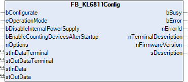

FB_KL6811Config 1:
The function block FB_KL6811Config is used to configure the KL6811. The configuration is executed when the PLC program starts, or it can be triggered by a positive edge at the input bConfigurate. The parameters are stored in the respective registers of the KL6811 in a fail-safe manner. In addition, some general information, such as the firmware version, is read from the KL6811.
FB_KL6811Config 2: Inputs
  bConfigurate                       : BOOL := FALSE;
  eOperationMode                     : E_DALIV2OperationMode := eDALIV2OperationModeDALI;
  bDisableInternalPowerSupply        : BOOL := FALSE;
  bEnableCountingDevicesAfterStartup : BOOL := FALSE;
  nOptions                           : DWORD := 0;
Type
bConfigurate
Configuration of the bus terminal is started by a positive edge at this input.
eOperationMode
Defines the operation mode of the terminal (DALI or DSI). Corresponds to register 32, bits 12 to 15 of the bus terminal.
If this input is TRUE, the internal DALI power supply of the terminal is disabled by the configuration. Corresponds to register 32, bit 3 of the bus terminal.
If this input is TRUE, the number of DALI devices is counted when the terminal starts. Corresponds to register 32, bit 4 of the bus terminal.
nOptions
DWORD
Reserved for future developments.
FB_KL6811Config 3: Inputs/outputs
  stInDataTerminal  : ST_DALIV2InData;
  stOutDataTerminal : ST_DALIV2OutData;
  stInData          : ST_DALIV2InData;
  stOutData         : ST_DALIV2OutData;
Type
stInDataTerminal
ST_DALIV2InData
Reference to the structure for communication with the KL6811
stOutDataTerminal
ST_DALIV2OutData
stInData
ST_DALIV2InData
Reference to the structure for communication with the function block FB_DALIV2Communication
stOutData
ST_DALIV2OutData
FB_KL6811Config 4: Outputs
  bBusy                : BOOL;
  bError               : BOOL;
  nErrorId             : UDINT;
  nTerminalDescription : WORD;
  nFirmwareVersion     : WORD;
  sDescription         : STRING;
Type
bBusy
This output is switched to TRUE as soon as an error occurs during the execution of a command. The command-specific error code is contained in nErrorId. Is reset to FALSE by the execution of a command at the inputs.
nErrorId
UDINT
Contains the command-specific error code of the most recently executed command. Is reset to 0 by the execution of a command at the inputs (see error codes).
WORD
Contains the terminal name (e.g. 6811). Corresponds to register 8 of the bus terminal.
nFirmwareVersion
WORD
Contains the firmware version. Corresponds to register 9 of the bus terminal.
sDescription
STRING
Terminal name and firmware version as string (e.g. 'Terminal KL6811 / Firmware 2H')
