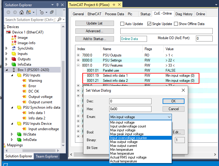

2. Select the info data via the CoE-Online tab under object 0x8001 "PSU Features".
Double-click on the object 0x8001:19 "Select Info data 1" or 0x8001:21 "Select Info data 2"
The "Set Value Dialog" dialog box opens
Select the desired entry from the drop-down menu under "Enum" (see following tables).
The following sizes from "PSU Diag Data" can be selected
Close the dialog box with "OK"
Selecting the info data 3:Fig.121: Select info data under "PSU Features" using PS2001-2420-1001 as an example
