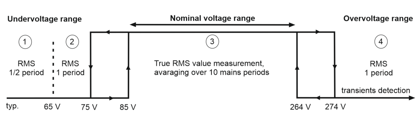

The undervoltage range begins when the voltage falls below 75 V AC and is exited again when it exceeds 85 V AC. A hysteresis of 10 V AC is stored here. There are two measuring principles within the undervoltage range:
- from 0 - 65 V AC: effective power measurement over ½ mains period
- from 65 - 75 V AC: effective power measurement over 1 mains period
The overvoltage range begins when 274 V AC is exceeded and is exited again when the value falls below 264 V AC. A hysteresis of 10 V AC is stored here.
Peak voltages are measured up to a level of 700 V.
Rapid overvoltages and transients
Rapid overvoltages and transients are also detected by the PS2001-xxxx-1001 power supplies. For example, the VDE-0160 pulse and surge pulses from 750 V are detected.
Measuring times of the effective power measurement as a function of the input voltage
Input voltage range | Measuring principle: | ||
Undervoltage | 1 | < 65 V AC | Effective power measurement over ½ mains period |
2 | 65 - 75 V AC | Effective power measurement over 1 mains period | |
Nominal voltage | 3 | 85 - 264 V AC | Effective power measurement, averaging over 10 mains periods |
Overvoltage | 4 | < 274 V AC | Effective power measurement over 1 mains period, transient detection |
Device-specific transmission times of typically 3 ms and the set cycle time are added to the measuring times.
