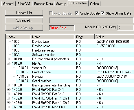

If a device has a CoE list, it is shown in the TwinCAT System Manager as a separate tab with a listing of the elements:
CoE Interface 2:
Fig.9: “CoE Online” tab
The figure “’CoE Online’ tab” shows the CoE objects available in device “EL2502”, ranging from 0x1000 to 0x1600. The subindices for 0x1018 are expanded.

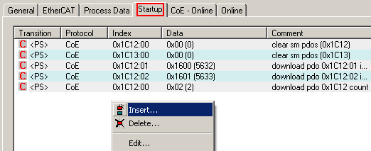

    Startup list
    Changes in the local CoE list of the terminal are lost if the terminal is replaced. If a terminal is replaced with a new Beckhoff terminal, it will have the default settings. It is therefore advisable to link all changes in the CoE list of an EtherCAT slave with the Startup list of the slave, which is processed whenever the EtherCAT fieldbus is started. In this way a replacement EtherCAT slave can automatically be parameterized with the specifications of the user.
    If EtherCAT slaves are used which are unable to store local CoE values permanently, the Startup list must be used.
    Recommended approach for manual modification of CoE parameters
    CoE Interface 5:
    Fig.10: Startup list in the TwinCAT System Manager
    The Startup list may already contain values that were configured by the System Manager based on the ESI specifications. Additional application-specific entries can also be created.

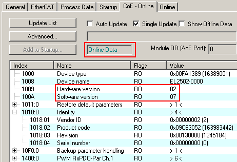

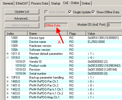

    Online / offline list
    When working with the TwinCAT System Manager, a distinction must be made as to whether the EtherCAT device is currently "available", i.e. switched on and connected via EtherCAT - i.e. online - or whether a configuration is created offline without slaves being connected.
    In both cases a CoE list as shown in Fig. “CoE online tab” is displayed. The connectivity is shown as offline/online.
