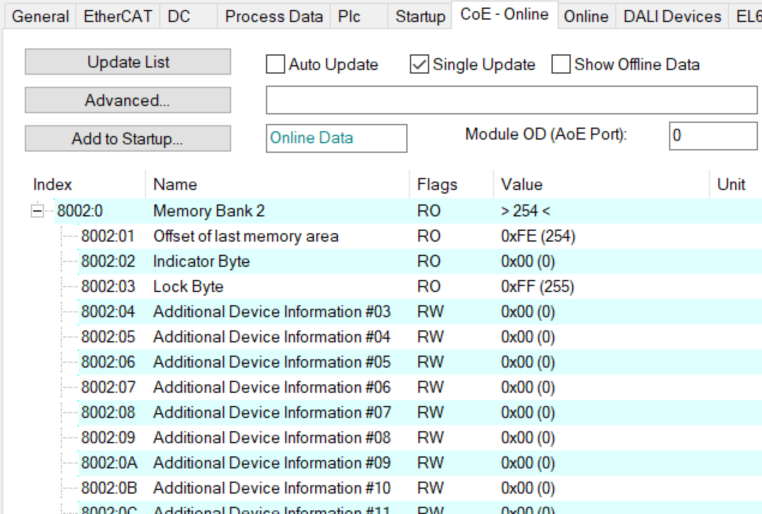

Access to memory bank 2 on the EL6821
Since the KL6821/EL6821 represents a DALI control device according to IEC 62386, the Bus Terminal must offer memory bank 0 and memory bank 1. Other DALI control devices can access these memory banks via the corresponding DALI commands.
In addition, the EL6821 offers memory bank 2. In the EL6821 memory bank 2 is mapped by CoE object 16#8002. The first three fields (16#8002:01 ... 16#8002:03) are defined by IEC 62386 (see above). The fields 16#8002:04 to 16#8002:FF can be written and/or read individually.
Note that the offset in memory bank 2 and the subindex are shifted from the CoE. Thus, offset 10 in memory bank 2 corresponds to field 16#8002:0B.
The function blocks FB_DALI102ReadMemoryLocation/FB_DALI103ReadMemoryLocation or FB_DALI102WriteMemoryLocationNoReply/FB_DALI103WriteMemoryLocationNoReply are available for accessing the memory banks of a DALI device via the DALI bus.
If memory bank 2 of the own EL6821 is to be accessed from a PLC program, access is via the EtherCAT CoE interface. The TwinCAT library Tc2_EtherCAT offers the necessary function blocks for this (see FB_EcCoeSdoRead and FB_EcCoeSdoWrite).
The following example reads offset 3 (subindex 4) and writes offset 4 (subindex 5) of memory bank 2. The EL6821 must be located at the same controller where the PLC program is executed.
