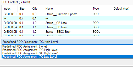

High/low-level communication
The PDO setting can be used to set the representation of the communication levels between high and low level or direct current (DC) and alternating current (AC) charging:
Notes to Commissioning 1:Fig.86: Predefined PDO

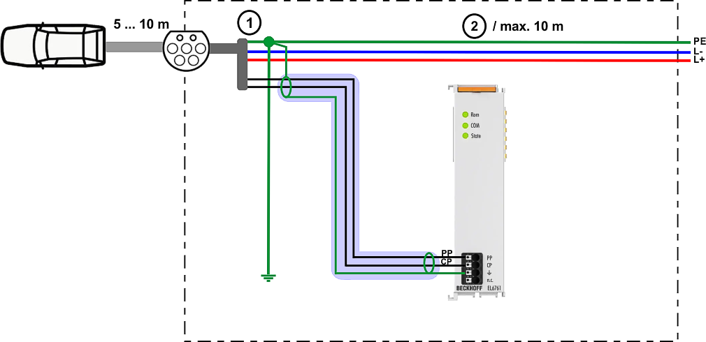

Example circuit EL6761
Notes to Commissioning 2:Fig.87: Example circuit EL6761
Point 1 - common grounding
Point 2 - the shielded power for forwarding the CP signal should not be longer than 15 m, as the total line is limited by standards to 30 m. The remaining length can be used for the cable to the EV.
The EL6761 terminal is intended exclusively for providing communication between it (or the charging station function implemented in the customer application, EVSE) and an EV. Many other functions are missing for a charging station function, such as the provision of power electronics to ensure the desired energy transfer.
