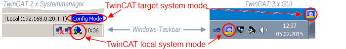

The online search is not available in RUN mode (production operation). Note the differentiation between TwinCAT programming system and TwinCAT target system.
The TwinCAT 2 icon (ONLINE configuration creation 6:) or TwinCAT 3 icon (ONLINE configuration creation 7:) within the Windows-Taskbar always shows the TwinCAT mode of the local IPC. Compared to that, the System Manager window of TwinCAT 2 or the user interface of TwinCAT 3 indicates the state of the target system.
ONLINE configuration creation 8:Fig.168: Differentiation local/target system (left: TwinCAT 2; right: TwinCAT 3)

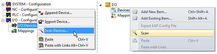

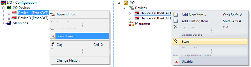

Right-clicking on “I/O Devices” in the configuration tree opens the search dialog.
ONLINE configuration creation 9:Fig.169: Scan Devices (left: TwinCAT 2; right: TwinCAT 3)

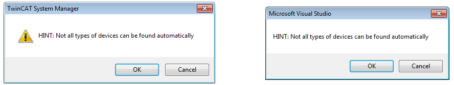

This scan mode attempts to find not only EtherCAT devices (or Ethernet ports that are usable as such), but also NOVRAM, fieldbus cards, SMB etc. However, not all devices can be found automatically.
ONLINE configuration creation 10:Fig.170: Note for automatic device scan (left: TwinCAT 2; right: TwinCAT 3)

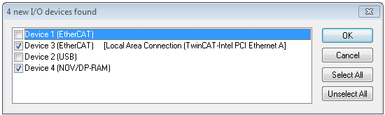

Ethernet ports with installed TwinCAT real-time driver are shown as “RT Ethernet” devices. An EtherCAT frame is sent to these ports for testing purposes. If the scan agent detects from the response that an EtherCAT slave is connected, the port is immediately shown as an “EtherCAT Device” .
ONLINE configuration creation 11:Fig.171: Detected Ethernet devices
Via respective checkboxes devices can be selected (as illustrated in Fig. “Detected Ethernet devices” e.g. Device 3 and Device 4 were chosen). After confirmation with “OK” a device scan is suggested for all selected devices, see Fig.: “Scan query after automatic creation of an EtherCAT device”.

If an EtherCAT device was created in the configuration (manually or through a scan), the I/O field can be scanned for devices/slaves.

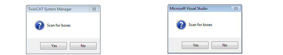

ONLINE configuration creation 17:Fig.175: Scan query after automatic creation of an EtherCAT device (left: TwinCAT 2; right: TwinCAT 3)
ONLINE configuration creation 18:Fig.176: Manual scanning for devices on a specified EtherCAT device (left: TwinCAT 2; right: TwinCAT 3)

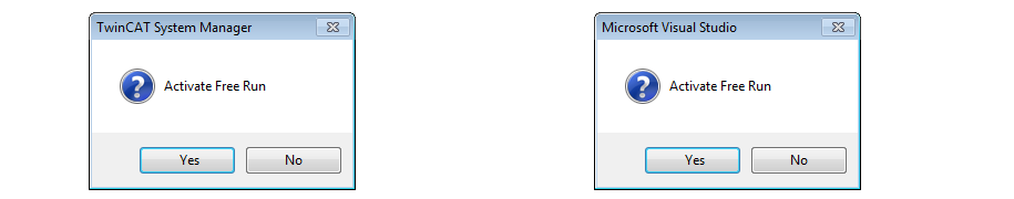

The configuration is established and can then be switched to online state (OPERATIONAL).
ONLINE configuration creation 20:Fig.178: Config/FreeRun query (left: TwinCAT 2; right: TwinCAT 3)
In Config/FreeRun mode the System Manager display alternates between blue and red, and the EtherCAT device continues to operate with the idling cycle time of 4 ms (default setting), even without active task (NC, PLC).
ONLINE configuration creation 21:Fig.179: Displaying of “Free Run” and “Config Mode” toggling right below in the status bar
ONLINE configuration creation 22:Fig.180: TwinCAT can also be switched to this state by using a button (left: TwinCAT 2; right: TwinCAT 3)

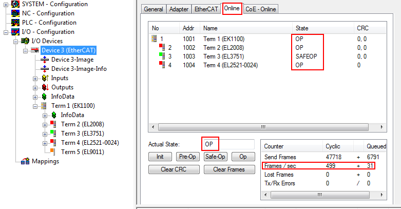

The EtherCAT system should then be in a functional cyclic state, as shown in Fig. Online display example.
ONLINE configuration creation 23:Fig.181: Online display example

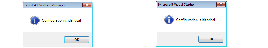

If a scan is initiated for an existing configuration, the actual I/O environment may match the configuration exactly or it may differ. This enables the configuration to be compared.
ONLINE configuration creation 25:Fig.183: Identical configuration (left: TwinCAT 2; right: TwinCAT 3)

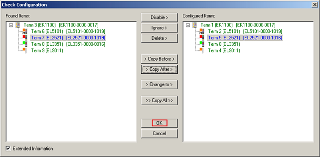

If differences are detected, they are shown in the correction dialog, so that the user can modify the configuration as required.
ONLINE configuration creation 26:Fig.184: Correction dialog

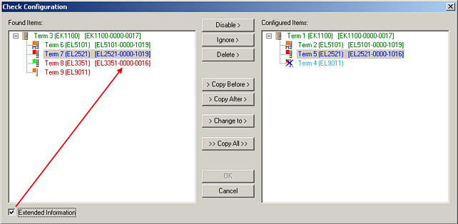

It is advisable to tick the “Extended Information” check box to reveal differences in the revision.
Color
Explanation
green
This EtherCAT slave matches the entry on the other side. Both type and revision match.
blue
This EtherCAT slave is present on the other side, but in a different revision. This other revision can have other default values for the process data as well as other/additional functions.
If the found revision is higher than the configured revision, the slave may be used provided compatibility issues are taken into account.
If the found revision is lower than the configured revision, it is likely that the slave cannot be used. The found device may not support all functions that the master expects based on the higher revision number.
light blue
This EtherCAT slave is ignored (“Ignore” button)
red
  • This EtherCAT slave is not present on the other side.
  • It is present, but in a different revision, which also differs in its properties from the one specified.
    The compatibility principle then also applies here: if the found revision is higher than the configured revision, use is possible provided compatibility issues are taken into account, since the successor devices should support the functions of the predecessor devices.

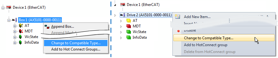

Change to Compatible Type
TwinCAT offers a function Change to Compatible Type… for the exchange of a device whilst retaining the links in the task.
ONLINE configuration creation 30:Fig.187: Dialog “Change to Compatible Type…” (left: TwinCAT 2; right: TwinCAT 3)

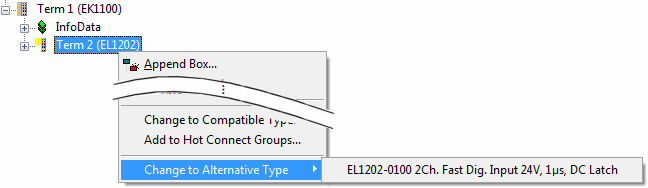

Change to Alternative Type
The TwinCAT System Manager offers a function for the exchange of a device: Change to Alternative Type
ONLINE configuration creation 31:Fig.188: TwinCAT 2 Dialog Change to Alternative Type
If called, the System Manager searches in the procured device ESI (in this example: EL1202-0000) for details of compatible devices contained there. The configuration is changed and the ESI-EEPROM is overwritten at the same time – therefore this process is possible only in the online state (ConfigMode).
