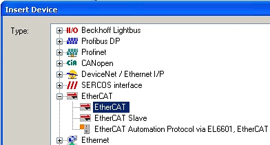

Create an EtherCAT device in an empty System Manager window.
OFFLINE configuration creation 1:Fig.158: Append EtherCAT device (left: TwinCAT 2; right: TwinCAT 3)
Select type “EtherCAT” for an EtherCAT I/O application with EtherCAT slaves. For the present publisher/subscriber service in combination with an EL6601/EL6614 terminal select “EtherCAT Automation Protocol via EL6601”.
OFFLINE configuration creation 2:Fig.159: Selecting the EtherCAT connection (TwinCAT 2.11, TwinCAT 3)

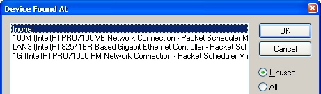

Then assign a real Ethernet port to this virtual device in the runtime system.
OFFLINE configuration creation 3:Fig.160: Selecting the Ethernet port

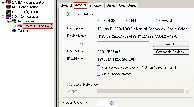

This query may appear automatically when the EtherCAT device is created, or the assignment can be set/modified later in the properties dialog; see Fig. “EtherCAT device properties (TwinCAT 2)”.
OFFLINE configuration creation 4:Fig.161: EtherCAT device properties (TwinCAT 2)

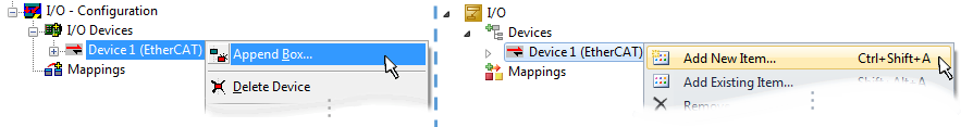

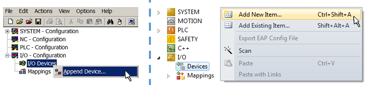

Further devices can be appended by right-clicking on a device in the configuration tree.
OFFLINE configuration creation 7:Fig.162: Appending EtherCAT devices (left: TwinCAT 2; right: TwinCAT 3)

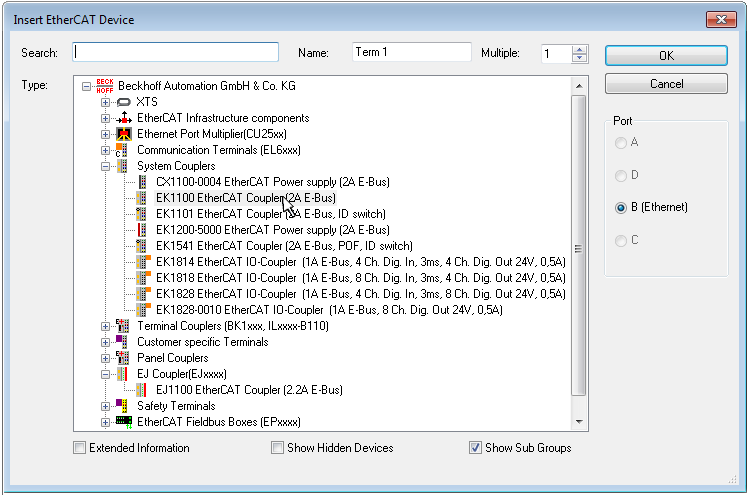

The dialog for selecting a new device opens. Only devices for which ESI files are available are displayed.
Only devices are offered for selection that can be appended to the previously selected device. Therefore, the physical layer available for this port is also displayed (Fig. “Selection dialog for new EtherCAT device”, A). In the case of cable-based Fast-Ethernet physical layer with PHY transfer, then also only cable-based devices are available, as shown in Fig. “Selection dialog for new EtherCAT device”. If the preceding device has several free ports (e.g. EK1122 or EK1100), the required port can be selected on the right-hand side (A).
Overview of physical layer
The search field facilitates finding specific devices (from TwinCAT 2.11 or TwinCAT 3).
OFFLINE configuration creation 8:Fig.163: Selection dialog for new EtherCAT device

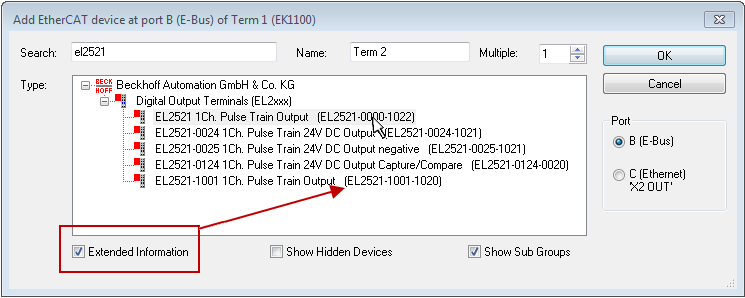

By default, only the name/device type is used as selection criterion. For selecting a specific revision of the device, the revision can be displayed as “Extended Information”.
OFFLINE configuration creation 9:Fig.164: Display of device revision

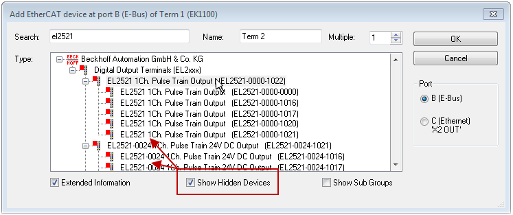

In many cases several device revisions were created for historic or functional reasons, e.g. through technological advancement. For simplification purposes (see Fig. “Selection dialog for new EtherCAT device”) only the last (i.e. highest) revision and therefore the latest state of production is displayed in the selection dialog for Beckhoff devices. To show all device revisions available in the system as ESI descriptions tick the “Show Hidden Devices” check box, see Fig. “Display of previous revisions”.
OFFLINE configuration creation 10:Fig.165: Display of previous revisions

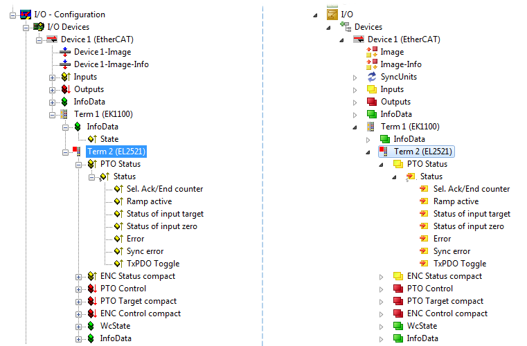

In this case the process image of the device is shown in the configuration tree and can be parameterized as follows: linking with the task, CoE/DC settings, plug-in definition, startup settings, ...
OFFLINE configuration creation 13:Fig.167: EtherCAT terminal in the TwinCAT tree (left: TwinCAT 2; right: TwinCAT 3)
