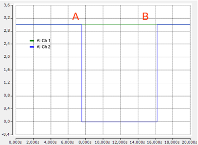

Tare 8:
Fig.53: Example: 3 V are applied simultaneously to Ch1+2 of an EL4374 at the same time, Filter1 = IIR8
At (A), “Control.Tare” is set to 1 on Channel 2 (and the bit is then reset); the tare value is displayed in the CoE:
Tare 9:
Fig.54: “Tare Value”
As expected, the measured value goes to ~0.
At (B), tare is deleted again by command. Channel 1 runs without tare for comparison.
