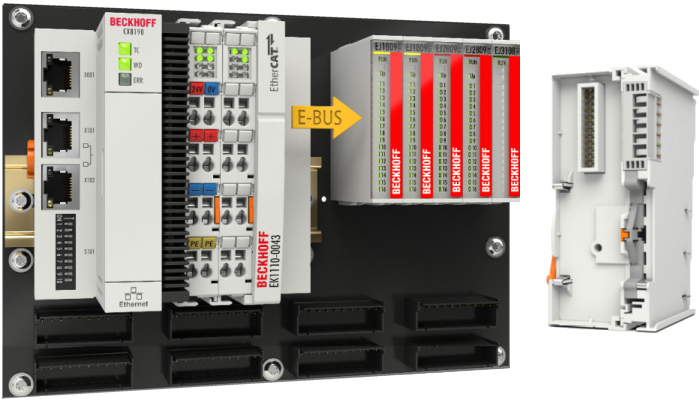

E-bus power supply with CXxxxx and EK1110-004x
The Embedded PC supplies the attached EtherCAT Terminals and the EtherCAT EJ coupler
- with a supply voltage Us of 24 VDC (-15 %/+20 %). This voltage supplies the E‑bus and the bus terminal electronics.
 The CXxxxx units supply the E‑bus with up to 2,000 mA E‑bus current. If a higher current is required due to the attached terminals, power feed terminals or power supply plug‑in modules must be used for the E‑bus supply.
- with a peripheral voltage Up of 24 VDC to supply the field electronics.
The EK1110‑004x EtherCAT EJ couplers relay the following parameters to the signal distribution board via the rear connector:
- the E‑bus signals,
- the E‑bus voltage UEBUS (3.3 V) and
- the peripheral voltage UP (24 VDC).
