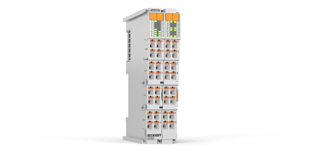

EtherCAT Terminal, 2-channel motion interface, stepper motor, 48 V DC, 3 A, push-in, with incremental encoder, 5 V DC
The ED7062 EtherCAT Terminal is designed for direct connection of two stepper motors in the medium power range up to 3 A and for a voltage range from 8 V DC to 48 V DC.
The stepper motor output stage is integrated into the EtherCAT Terminal in a compact design together with two digital inputs for limit switches and an encoder interface for various 5 V encoders. Parameterization allows the ED7062 to be optimally adapted to the corresponding motor and the requirements of the application. Fine microstepping ensures particularly quiet and precise motor operation.
In combination with a suitable stepper motor, the ED7062 represents a compact and economical drive solution.
Special features:
- integrated travel path control
- encoder input
- additional digital inputs
The ED-series EtherCAT Terminals have push-in connection technology which makes wiring easy and tool-free.
