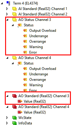

AO Status
The output channel also has optional diagnostic data that can be activated as a status word:
AO Status 1:
Fig.43: Status word analog output
Interpretation:
Function
[Type]
Output Overload
[Bool]
Under-
range
[Bool]
Over-
range
[Bool]
Warning
[Bool]
Error +
Error LED
[Bool]
DiagMessage
Meaning
Bit position (from 0)
SW.1
SW.2
SW.3
SW.5
SW.6
x
x
x
Analog output overload: wire break at I output, short circuit at U output
x
x
Limiter Low limit undershot
x
x
Limiter High limit exceeded
x
x
Real32 setpoint < OFSVtechn
x
x
Real32 setpoint > OFSVtechn
x
DAC error
x
x
Warning Level Low/High exceeded
Internal overtemperature detected -> cooling required
Voltage at the power contacts too low (see 0xF900:01/15 Device information: Output operation not protected!)
