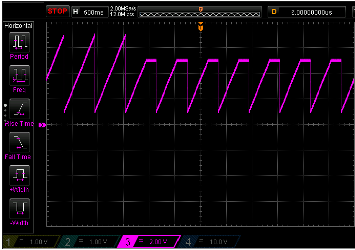

Example: Sawtooth 1…7 V is output and then a “Limiter High Value” of 5 V is set:
Limiter 3:
Fig.62: Index 0x80nD set to 5 V
Limiter 4:
Fig.63: Sawtooth output
The overrange is counted accordingly below:
Limiter 5:
Fig.64: Counter overrange
