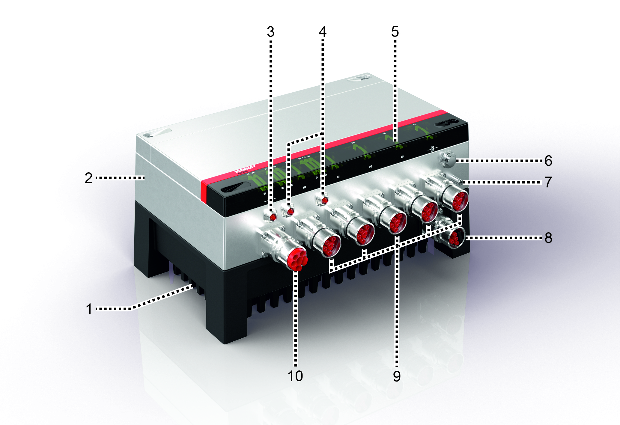

AMP8620 power supply module
Item number | Explanation |
1 | Heat sink |
2 | Housing |
3 | X10: fieldbus input for EtherCAT; M8 P-coded |
4 | X20 and X21: fieldbus output for EtherCAT P; M8; |
5 | Display of the status LEDs |
6 | Pressure compensation element |
7 | Ground connection |
8 | Only for AMP8620-2005-02x0 [+]: X71: connection for external braking resistor |
9 | X40 to X44: AMP8000 system output B23 |
10 | Slot X01: connection of the supply network |
