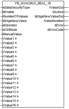

FB_HVACMUX_REAL_16
FB_HVACMUX_REAL_16 1:

eDataSecurityType : E_HVACDataSecurityType;
bEnable           : BOOL;
iNumberOfValues   : INT;              1..16
bEdgeNewValue     : BOOL;
bDirection        : BOOL;
eCtrlMode         : E_HVACCtrlMode;
iManualValue      : INT;              0..16

rValueOut          : REAL;
bActive            : BOOL;
bEdgeNewValueOut   : BOOL;
iValueNumber       : INT;
bError             : BOOL;
eErrorCode         : E_HVACErrorCodes;

rValue1-16        : REAL;
