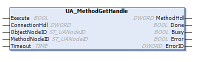

UA_MethodGetHandle
This function block collects a handle for a UA method, which can then be used to call a method using UA_MethodCall.

Outputs
MethodHdl : DWORD;
Done : BOOL;
Busy : BOOL;
Error : BOOL;
ErrorID : UDINT;
END_VAR Name | Type | Description |
MethodHdl | DWORD | Returns a method handle that can be used to call a method via UA_MethodCall. |
Done | BOOL | Switches to TRUE if the function block was executed successfully. |
Busy | BOOL | TRUE until the function block has executed a command, at the most for the duration of the "Timeout" at the input. The inputs accept no new command as long as Busy = TRUE. It is not the connection time that is monitored but the reception time. |
Error | BOOL | Switches to TRUE if an error occurs while executing a command. The command-specific error code is contained in nErrID. |
ErrorID | UDINT | Contains the command-specific error code of the most recently executed command. |
