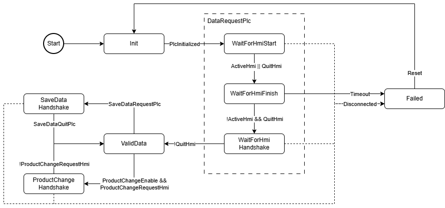

FB_PlcStateToHmi
FB_PlcStateToHmi 1:
Implements the handshake procedure for the TF8550 recipe management on the PLC side.
FB_PlcStateToHmi 2:
Syntax:
FUNCTION_BLOCK FB_PlcStateToHmi EXTENDS FB_HandshakeHmi

FB_HandshakeHmi

FB_PlcStateToHmi 6: Interfaces
Type
I_Base
Standard interface on FB_Base.
I_RecipeState
Interface for the handshake variables to be processed in the main procedure.
I_VersionInfo
Interface to the properties with version information.
I_HandshakeHmi
Standard interface on FB_HandshakeHmi
I_BaseDev
Covers all methods and properties of the base class.
I_Comparable
Enables comparisons via _IsMyself() or F_IsSameInstance().
