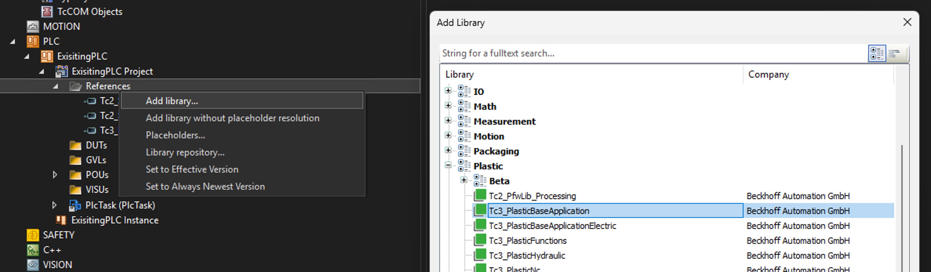

How do I integrate the Plastic Base Application into my existing project?
You can add the Plastic Base Application to your PLC project as the Tc3_PlasticBaseApplication library at References.

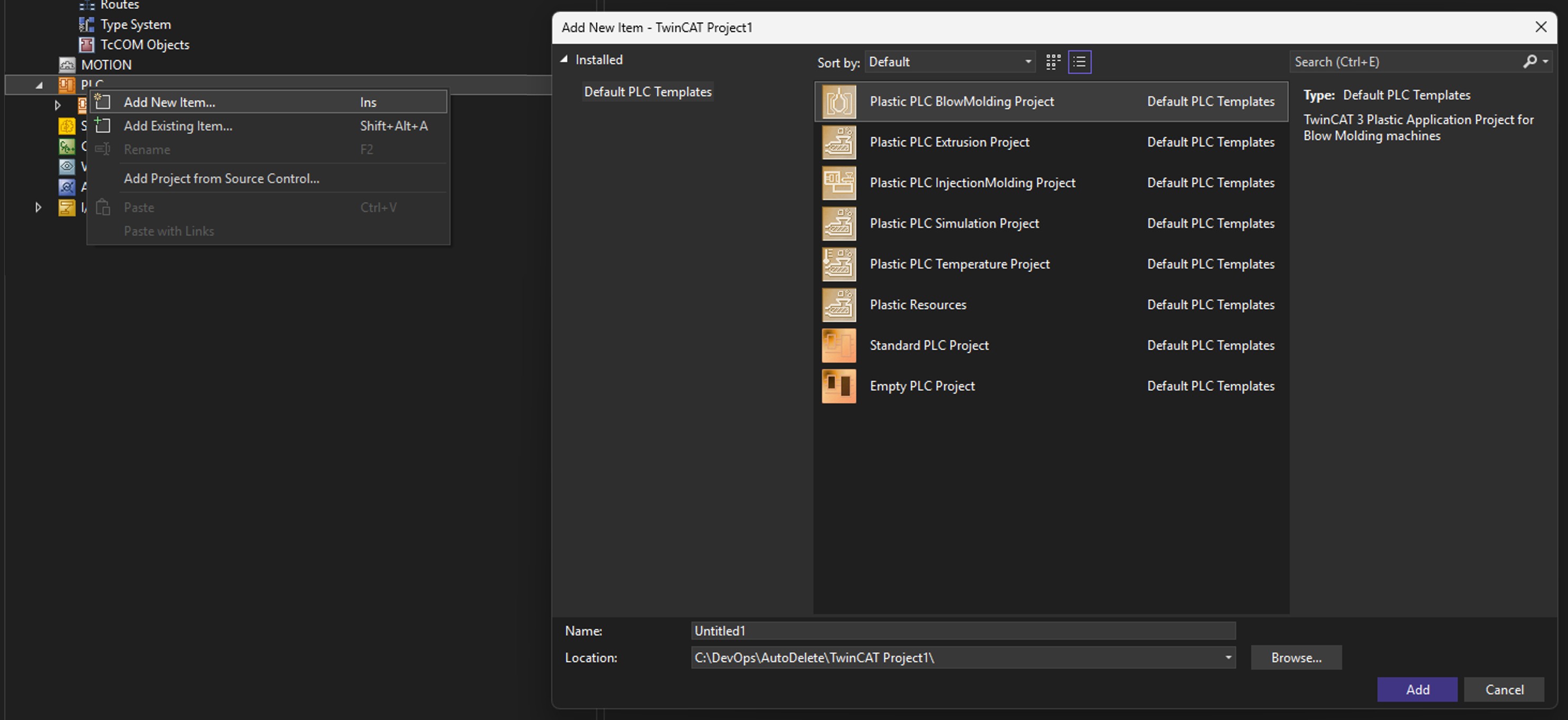

You can add a Plastic Application machine template to your TwinCAT project as a new PLC project.

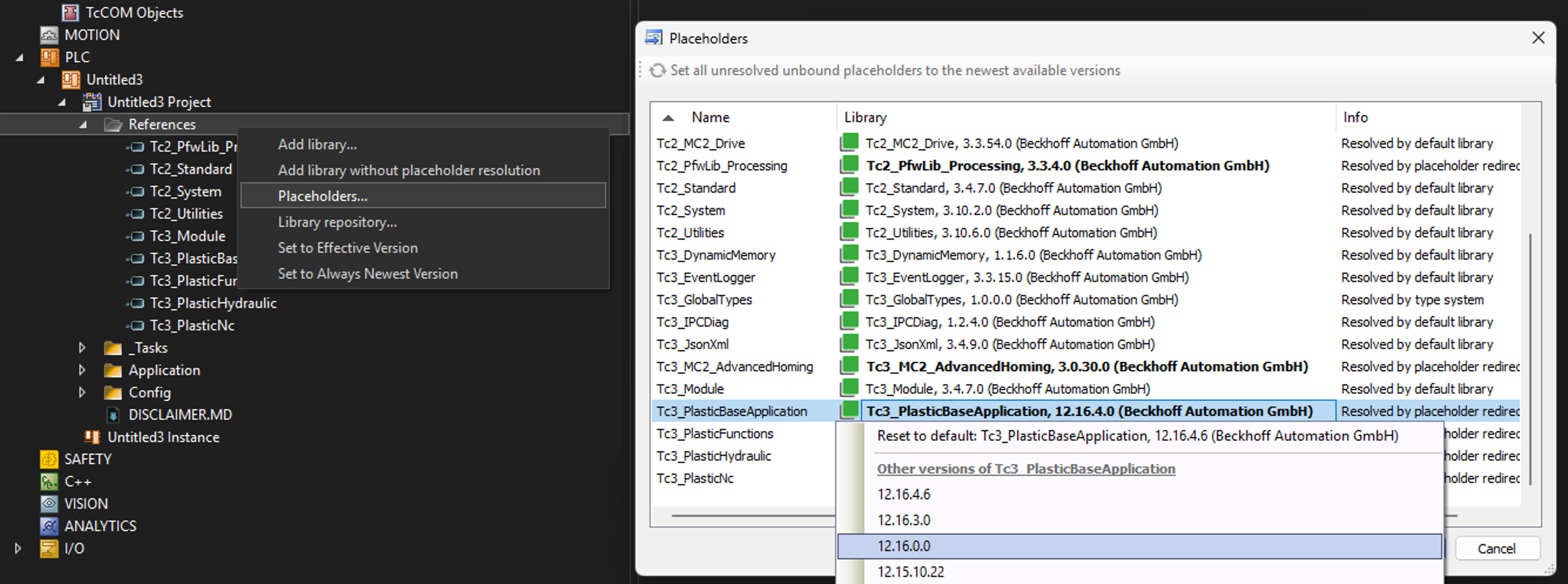

My project uses an older version of the Plastic Base Application. How can I update the library?
After you have installed or updated the library using the TwinCAT Package Manager, you can set the version via the Placeholder in your PLC project.
