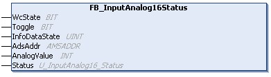

InputAnalog16Status
InputAnalog16Status 1:
This class can be used for a 16-bit analog input element with additional status information.
The following are currently explicitly supported:
Syntax:
FUNCTION_BLOCK FB_InputAnalog16Status EXTENDS FB_InputAnalog16
InputAnalog16Status 2: I/O variables
Type
Direction
WcState
BIT
Input
Working Counter State
Status
U_InputAnalog16_Status
Input
Detailed status value for a single analog input.
AnalogValue
INT
Input
Numerical signed analog input value.
AdsAddr
AMSADDR
Input
ADS address of the I/O element for asynchronous communication.
Toggle
BIT
Input
Cyclic switching bit that is synchronized with the update rate of the mapping. As a rule, the InputToggle of the WcState structure is mapped for this purpose.
InfoDataState
UINT
Input
Numerical information on the state of the EtherCAT slave (see State).
InputAnalog16Status 3: Properties
Type
Access
InputScale
DINT
Get, Set
Scale for scaling the input value.
InputAnalog16Status 4: Methods
Cyclic()
Cycle method
GetChannelState()
Reads the status word of the input element.
SetChannelState()
Writes the status word of the input element.
GetProcessIoStatus()
Reads the EtherCAT status of the input/output element.
SetProcessIoStatus()
Writes the EtherCAT status of the input/output element.
GetProcessValue()
Reads the terminal-specific input/output value.
SetProcessValue()
Writes the terminal-specific input/output value.
InputAnalog16Status 5: Interfaces
Type
I_IoBase
Standard interface on FB_IoBase.
I_InputAnalog16Status
Standard interface on FB_InputAnalog16Status.
I_InputAnalog16
Standard interface on FB_InputAnalog16.
I_InputBase
Standard interface on FB_InputBase.
I_IoEcAds
Standard interface on FB_IoEcAds.
I_IoEc
Standard interface on FB_IoEc.
