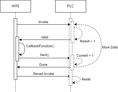

The ListQueryPlc function can be used for asynchronous data exchange with the PLC. The FB_ListQueryHmi PLC data type serves as the counterpart. Data exchange takes place according to the following scheme:
ListQueryPlc 1:
Parameter
Type
QuerySymbol
TcHmi.Symbol
Handshake symbol which is used for communication with the PLC. Based on the FB_ListQueryHmi. PLC data type
CallbackFunction
TcHmi.IFunction
Callback function that is used for further processing of the asynchronously queried data.
