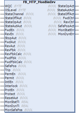

FB_MTP_MonBinDrv 1:
The function block FB_MTP_MonBinDrv is an object for controlling a binary drive from different sources: internal PLC logic or manual operation (e. g. via OPC UA). Switching requests are managed via the state machine of Operation Mode. It also includes the option of monitoring the output values with the respective feedback signals. The OPC UA access rights are described in the variable tables.

FB_MTP_MonBinDrv 3: Inputs
