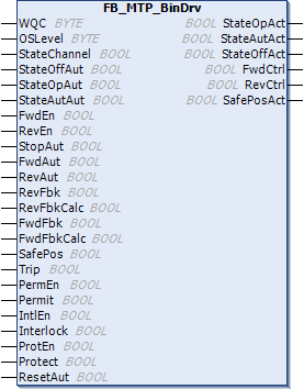

The function block FB_MTP_BinDrv is an object for controlling a binary drive from different sources: internal PLC logic or manual operation (e. g. via OPC UA). Switching requests are managed via the state machine of Operation Mode. The OPC UA access rights are described in the variable tables.
Controlling the drive
The direction of rotation of the drive is specified via the switching requests Fwd*, Rev* and Stop*. The state machine of the Operation Mode manages whether and from which source new switching requests are processed. With simultaneous requests from Fwd* and Rev*, both are prioritized equally and the drive remains in its state. Stop* is prioritized highest at SafePos = FALSE with simultaneous requests from Fwd*, Rev* and Stop*. If SafePos = TRUE, the switching requests Fwd*, Rev* and Stop* are prioritized equally and the drive remains in its current state in the event of simultaneous requests.
When Locking is active, it is no longer possible to control the drive, depending on the type of interlock.
Safety position
The safety position is defined via the variables SafePos, SafePosDirEn and SafePosDir.
The variable SafePos is used to specify whether the safety position of the drive is the de-energized state or an active state.
FB_MTP_BinDrv 2:
The variables SafePosDirEn and SafePosDir are not part of the MTP guideline. They have also been implemented and can be used to define a safety position in the active state. These variables are not listed in the MTP file and are not made available via OPC UA.
Safety position: de-energized state
In the de-energized state, the safety position of the drive is: FwdCtrl = FALSE and RevCtrl = FALSE.
Safety position: active state
For the active state, the default direction of rotation can be enabled (SafePosDirEn = TRUE) and the direction of rotation can be specified (SafePosDir).
If the specification of the direction of rotation is disabled SafePosDirEn = FALSE, the current movement state (forward, reverse or stop) is the safety position.
If the default setting is enabled, the safety position SafePosDirEn = TRUE forward (SafePosDir = FALSE) or reverse (SafePosDir = TRUE).
