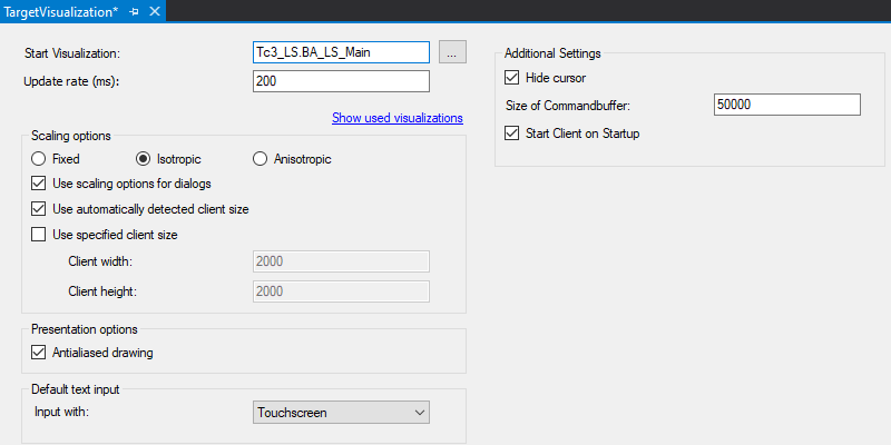

Setting up the visualization 2:

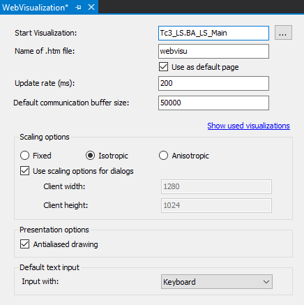

The start visualization for the target and web visualization must be linked as follows:
"Tc3_LS.BA_LS_Main"
If you use the web visualization without tablet, set the Default Text input to "Keyboard" so that the entries can be made via the keyboard.
