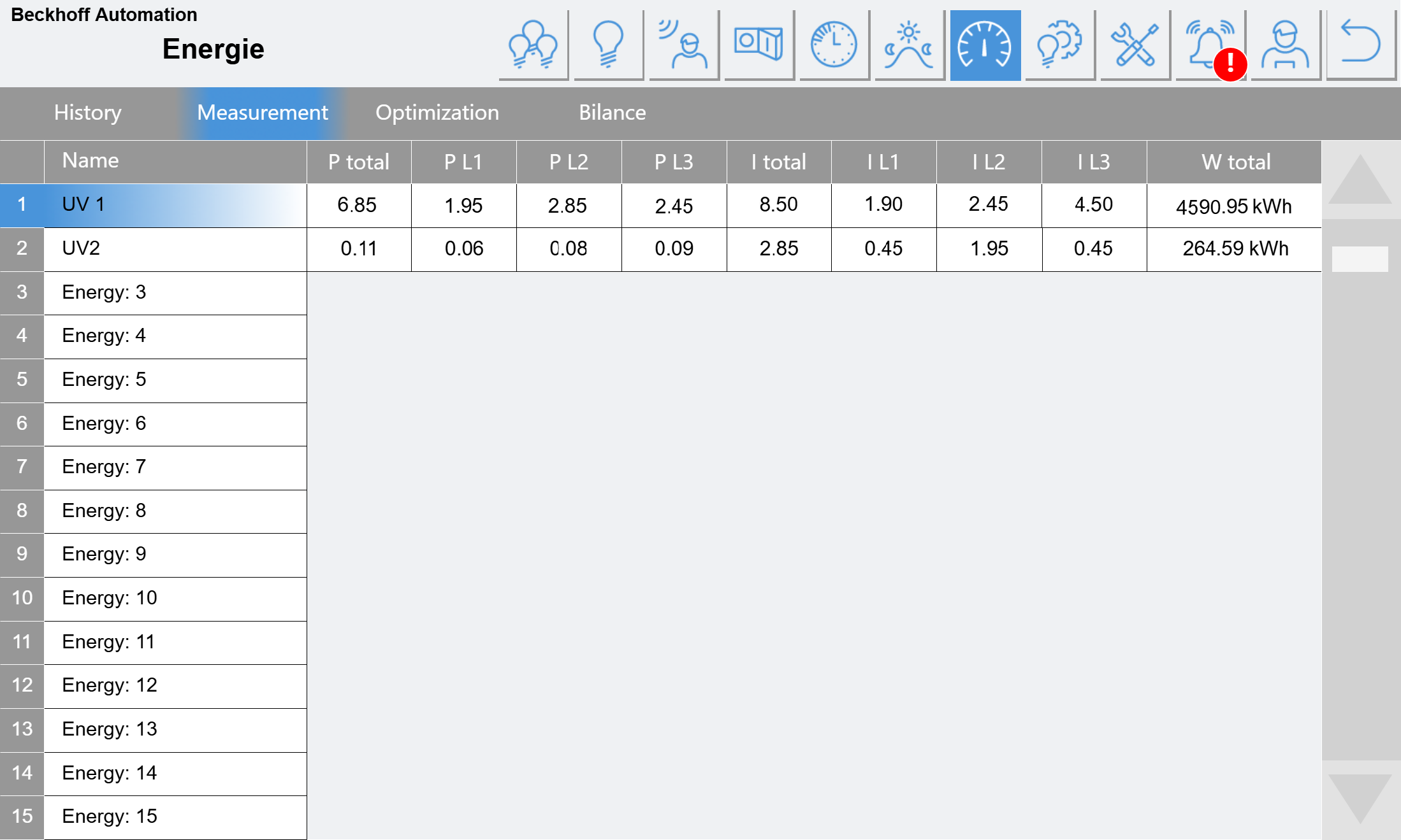

Measurement
Measurement 1:
Up to 15 measurements can be activated.
Notice
Observe the correct current direction
It is essential to observe the correct current direction of the transformer when connecting! (at the same time the physical input GVL_LS_IO. stIn_KL3403[x] and GVL_LS_IO. stOut_KL3403[x]).
The display contains live current and power values. The quarter-hourly average values over the last 24 hours are displayed in the dialog. The diagram display ranges from 0 to 50 kW.
All quarter-hourly values and the total kWh per day are backed up daily on the controller under "Active Energy kWh.csv" and "Active Power kW.csv" in the Energy folder. The path for backing up the files and for further use and evaluation can be changed in the Settings parameter (see Programming). The files can be downloaded from the controller by FTP.
