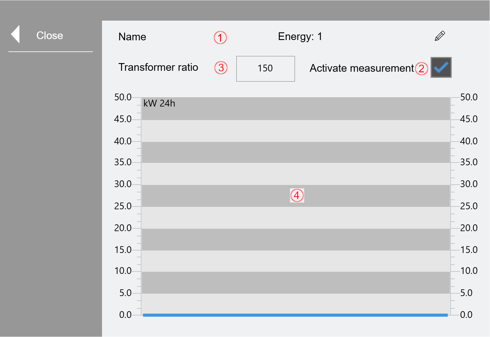

Measurement submenu
Measurement submenu 1:
(1)  The displayed name can be edited here.
(2)  Activate measurement. Only active measurements are processed by the program.
(3)  Depending on the upstream transformer, the correct ratio of primary current to secondary current must be specified here.
Notice Be sure to observe the notes on use of the KL3403!
(4)  Diagram of current power
