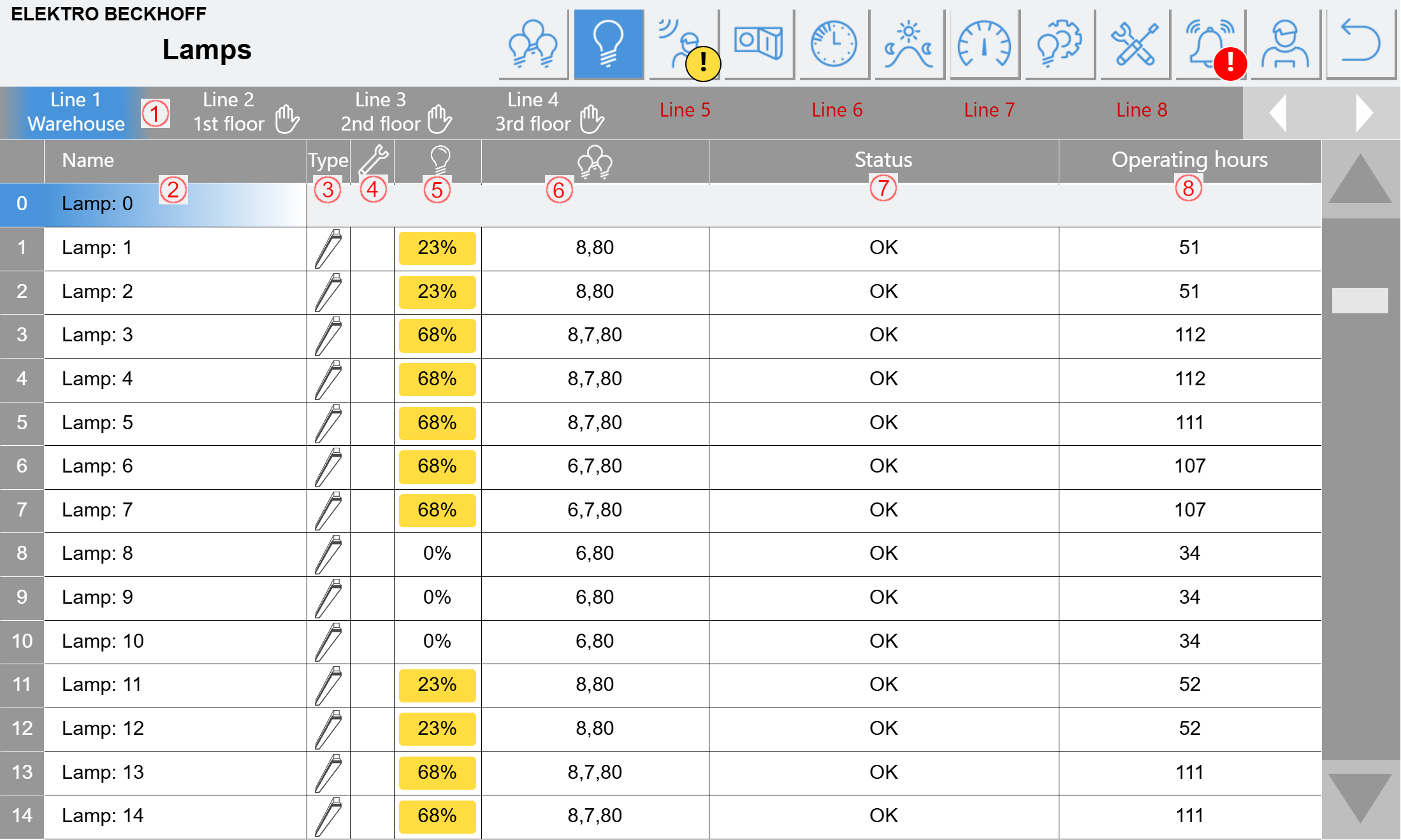

"Lamps" table
"Lamps" table 1:
(1)  Selection of the DALI line
(2)  Name of the lamp
(3)  Lamp type (see templates)
(4)  Service mode (red when active)
(5)  Setpoint of the lamp (highlighted in yellow when switched on or switched off by light control)
(6)  Groups assigned to the lamp
(7)  Status of the lamp ("OK" or error code)
(8)  Operating hours of the lamp
