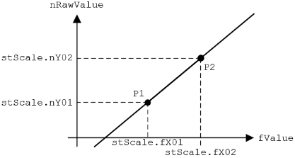

The function block FB_BA_AnalogOutput is used to control continuous actuators such as valves or dampers.
The input value fValue is converted into an analog value nRawValue by linear interpolation with 2 interpolation points.
Within the parameters, it is possible to activate upper (stHighLimit) and lower (stLowLimit) limit value monitoring of the output signal fPresentValue.

stScale : ST_BA_ScaleRealToInt := (fX01 := 0,fX02 := 100,nY01 := 0,nY02 := 32767);

stScale | The structure contains the interpolation points for linear interpolation. | |
